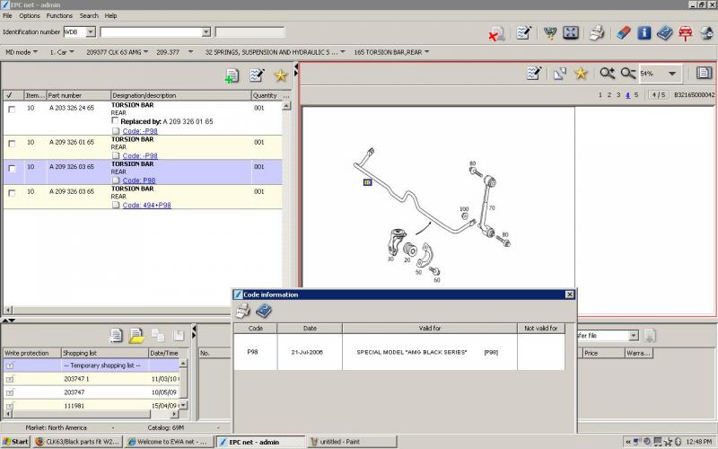

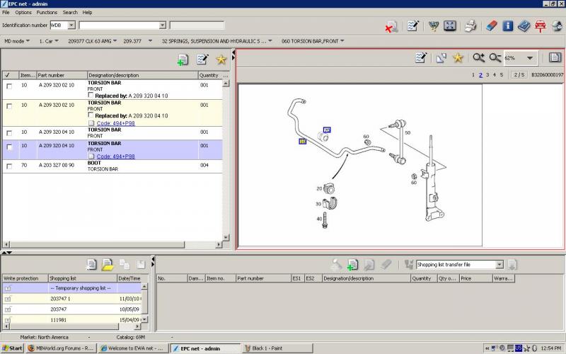

Sway Bars
OK guys here are the part # :
Rear
A2093260365 - for the Black
A2093260165 - for the Regular
A2033261281 - boot for the Regular and you need 2
A2033260881 - boot for the Black and you need 2
Front
A2093200410 - for Black and Regular
A2033270090 - boot for it and you need 2

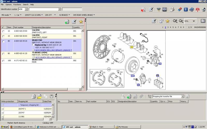

Old Jun 13, 2010 | 01:33 PM
hkirov's Avatar
Joined: Nov 2008
Posts: 74
From: Markham, ON, Canada
C230 Kompressor Coupe
Rear Brackes
here they are :
- A0034202983 - Caliper Left
- A0034203083 - Caliper Right
- A0054204120 - Brake Pads set
- A1714230212 - Rotors you need 2
same for Black and Reg CLK63
Attached Thumbnails CLK63/Black parts fit W203 and CL203-black-3.jpg

Old Jun 13, 2010 | 02:28 PM
dynomite05's Avatar
Joined: Apr 2008
Posts: 10,275
Likes: 10
From: Jerzy
04 CLK 320 > CLK32K
Originally Posted by hkirov
here they are :
Thank You!

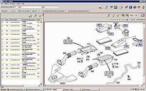

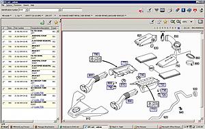

CLK 63/Black AIR Box
Originally Posted by M-bENZ
ur correct on that and the only difference is the front cover is abit shorter compare to M112. Anyway, please share if you can.
Thanks,
Andy
OK M8, i had no time to post all part numbers but here it is pics on all of them so you can read, will post the parts later one by one.
Attached Thumbnails CLK63/Black parts fit W203 and CL203-black-4.jpg   CLK63/Black parts fit W203 and CL203-black-5.jpg
