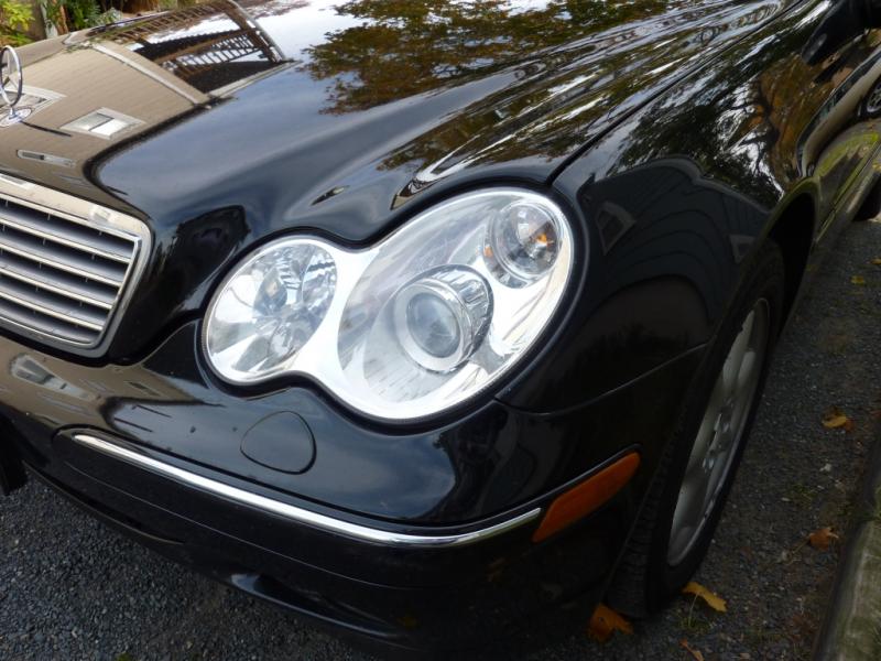

Anyway, was just outside and figured I'd take a shot of my headlights. Can anyone confirm if these are bi-xenons or not?

Those are factory fitted BiX with washers under those flaps & auto leveling. The proper set up.
You will hear many BS stories & that is one of them. Where are you? If in the US either buy the fluid from the dealer or use Fuchs Titan 4134 which is the latest fluid, readily available & approved. I can post all the approved fluids if you like but many are difficult to get.

Sweet deal. Surprised to find out they really are bi-xenons, have been reading up on the forum and AFAIK most 2004's only have the projectors.
Yes, unfortunately, I am in the US. Would love to be where you are though. Anyway, the guy must been out his mind, I figured it was a crock of doo-doo anyway.

Here are factory BiX fitted to my car
