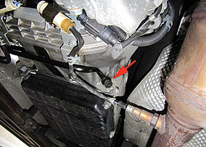

Also make sure that this banjo joint is tight.
