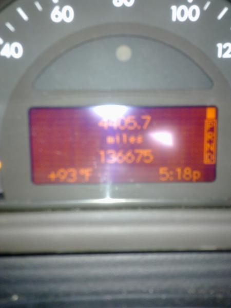

Time for some good news...here's mine after sitting in the Santa Barbara sun all day.
Thanks for all you've done Trey...sorry it turned into a cluster****

make sure the connector and wire is out of the way and that the clips are still springy and it should just push back in with a firm push.
