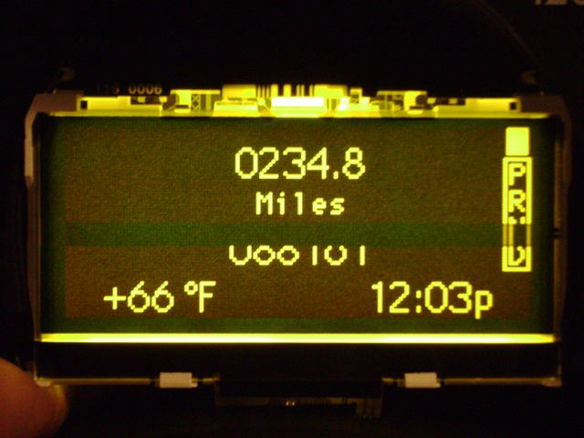

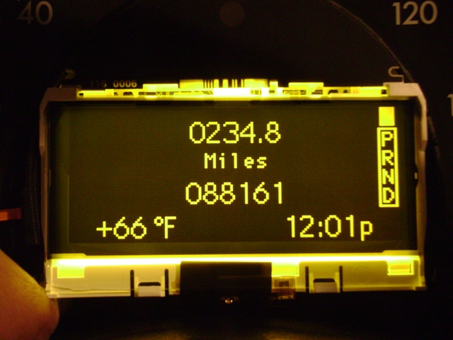

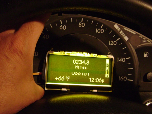

I'll post pics up a little later today, but I got mine in last night and one of the rows is bad (the one that goes across the 'N' in the gear selector, and top of mileage). I tried installing and re-installing several times, including swapping out with the original screen - definitely a problem with the new screen.
Any word back from the vendor Trey? Are we stuck with these defective units?

Replacement is absolutely AOK with me. Not sure of your address - could you pm me please? Pics below - 2 of the new screen showing the line out and one of the old. Interesting how the clock resets itself when doing this - there must be a RTC in the electronics assy.

Trey, I can confirm that the screen DOES in fact work on a Coupe. I am experiencing the same black row problem like you with the burnt out row of LEDs, however, the LCD screen itself works flawlessly.
