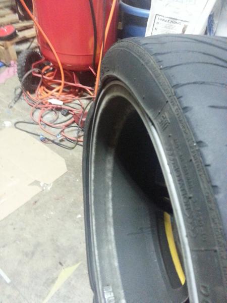

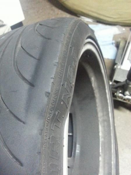

How does this even happen to a tire???
So after starting the day off locking my keys in the car yesterday, I of course had to end it with this crazyness. This is my front drivers side tire. I have no idea how or what happened. The pics dont do it justice its even gnarlier in person. What a day......

Looks like you hit a pot hole or bump hard and warped the tire

Yea my buddy said its the tirewall seperating, and its a defective tire. idk. They werent the most expensive or the cheapest, 160 per I think. I wish i could afford Perilli or somethin like that. But DEF not buying these again.

It is a bruise from running over something making an impact to the side wall. That tire is also overloaded.
Low profile tires are a fashion statement, and as you have discovered, not cheap. Put some stock wheel sized rims, and get a set of Michelin or Nitto's to have happy motoring.
Perilli (I think he means Pirelli ) has not made good tires since Italty ruled the world.

It's not just one area of the tire though. Its' got 3-4 separate areas that look almost dented in. Maybe I didnt explain it very well and its hard to show in pics. But each pic is actually from acompletely different area of the tire. Running over something could do that? Not sure I quite understand how. I could see if it was a section of the tire. But its more warped looking. But again I know close to nothing on the subject. So im differing to the more experienced on these things.

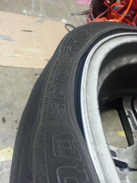

It does look overloaded now. But at first i couldnt tell what was wrong. The car was just pulling to the left. You can't see the damage with the wheel on, so I thought to check the air first and it was only at 36psi, which was maybe 5 min before i took it off and saw this. One blow can do this to 3 different sides of a tire?

I've been driving with a damaged rear-right tire for over 8 months now. The interior sidewall has multiple cracks and leaks about 2psi/day...but all I have to do is pump it back up before driving distance and all is good.
Your tire on the other hand looks like something more than just sidewall damage...shouldn't warp like that unless the tire is complete crap.

Most likely yes. My daughter's W203 also has 19" Nankangs that were put on by the PO. Two tires had tread separation just like the one in OP's case in a matter of just a few weeks from each others.
LOTS of tread still left on them, but the construction just sucks. Since I was pretty sure the remaining two will do the same soon, I replaced them all.
EDIT: Checked OP's pictures more closely and yes, his tires is exactly the same Nankang model my daughters car had. Get rid of all of them asap. You'll be much better off.

Looks like the tire areas are ballooning, which means the rubber is stretching, internal layers separating, etc. I wouldn't drive on these anymore unless you are planning to replace your rims and possibly fenders as well
Fyi this happened to one of my stock tires a couple of years after I purchased the car ... yes it was one of the new tires on the car from the factory ... so even good tires can have this problem.

FYI- Those 'fix a flat' aerosol cans will cause your tread to separate.
People don't seem to know that.
Thats bad, get a new tire quick before a blow out occurs.

That is a direct carcass delamination.

Can happen to any brand and any model of tire when you hit potholes and tear the inner plies of the side wall.
Nankang are decent taiwanese tires. They even sponsor local club races in taiwan.
