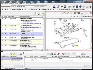

Assuming it's setup like the M111, which it probably is, there are these orings in the valve cover that compress over the holes where the plugs live. This has happened to folks with M111 engines, they pulled the valve cover and replaced the orings.
For me, I've never this problem, and perhaps that's because when I started to notice some leaks around the outside of the valves cover I tightened it.
So moral of the story is, check your valve cover, see if any of the bolts are loose.
Gently tighten them, check it frequently, and if necessary replace those farking O-rings.

Well curiosity got the best of me, here's a pic.
It's not exactly an oring, but here it is...
A2710160121- about $10 us each and there are 4 of them.
I used the VIN of a 2005 C230 off of ebay.

Where can I find number 35 on the picture by C230 sport Coup down in the comments?
Thanks
Old Apr 6, 2015 | 05:22 PM
chazzz's Avatar
Joined: Nov 2007
Posts: 145
From: Southern California
'05 MBZ C230K and '09 MBZ C350
Thanks
Get the part number you see in the picture and bring it to the nearest dealer, they should have it in stock. Or you can order online.
