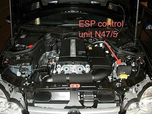

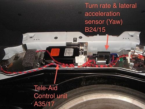

Wheel sensor, Yaw sensor in trunk bumped by something & needs re-plugging. Difference in rolling circimference rear wheels to front wheels exceeding 2%. Many possible reasons.
One common reason is corrosion in the ESP harness plug. Unplug & clean with switch cleaner. The ESP module is mounted on the face of the ABS block.
