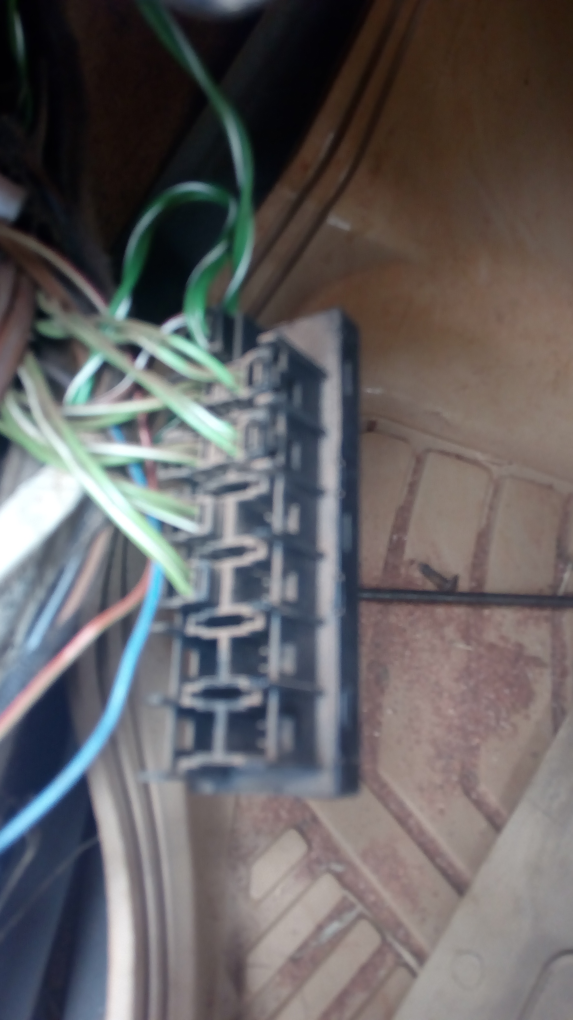

Please, what is this called? And what are the functions? If it is faulty, what symptoms would be observed?

part
I dont know what the part is other might so keep looking in wont you. I can see its nothing only a connector block .

My head's popping on this, almost .... I actually got a replacement SAM, not brand new though, couldn't get the wiper hook off (my bad) to swap it myself, so I decided to take it to a workshop to have it changed. So we decide to let the guy in the workshop run his diagnosis first & he says, "there's a short on your rear brake light" I knew that the rear brake light, left, was out, it was indicating on the dashboard already but that wouldn't be the reason the battery would drain, he looked through his scan tool again & mentions CAN bus, I then explained to him further the experience we've had & also that I had a replacement for the SAM, he says "your SAM is fine", I insisted show me what's wrong & he tells me, "you ain't a pro, let me do my job" after a series of discussions, he has the rug on the driver's side loosened, exposes that connector & says that's the bad guy .... He's yet to replace it but I'm trying to ensure the right thing is done .... That's why I need to know if this connector can cause a battery drain anyhow ....

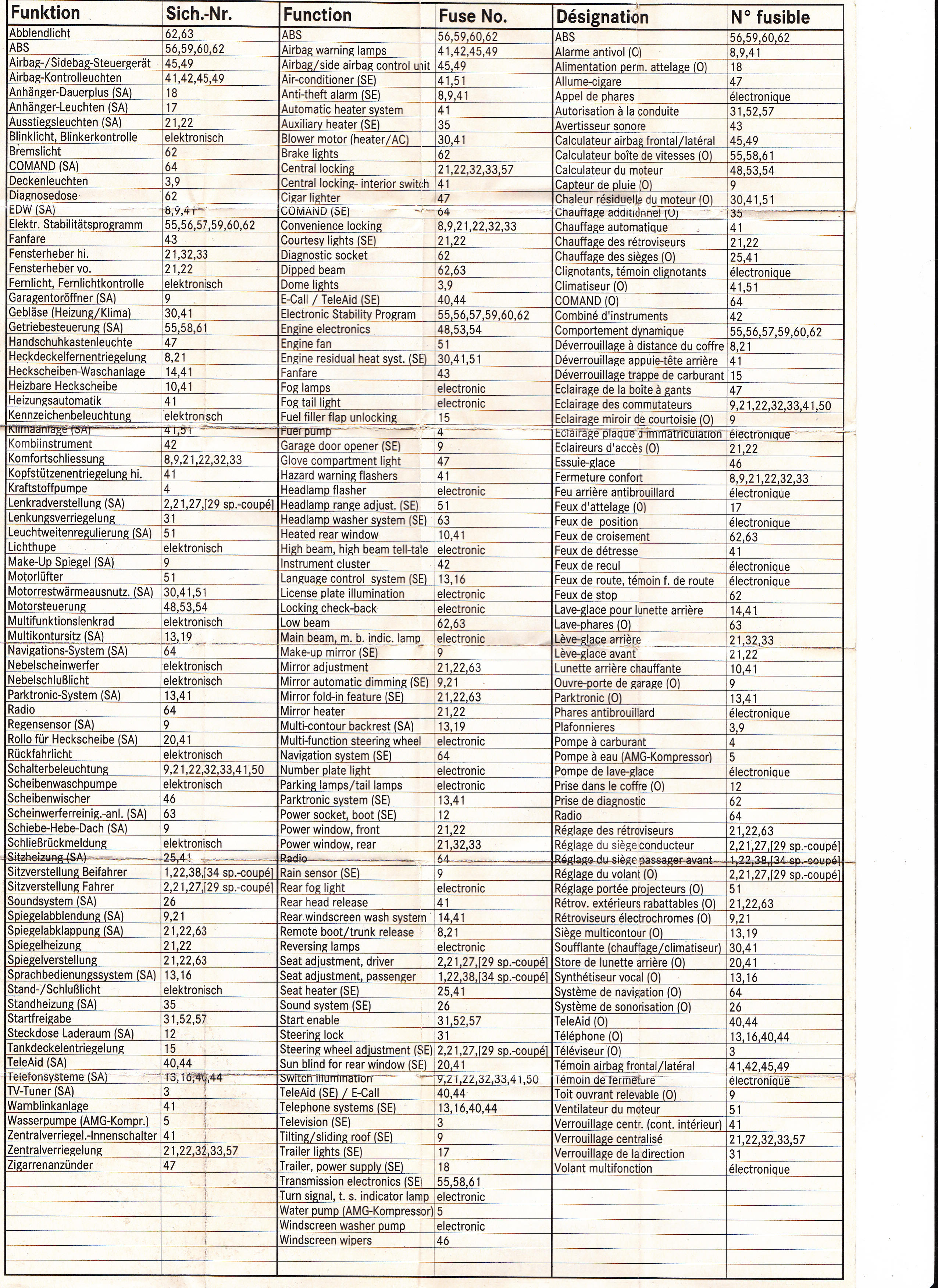

well, in my w203 (which is European market, year 2002, M271) brake lights are powered via no 62 fuse, 5A, but i'm not sure whether yours is the same. the photo of the connector is out of focus and i can't see much but check for "burns" i.e. charcoal like areas that can cause a short. if that's the case and your brake lights are powered via CANBUS the guy in the workshop might be on to something. inside the dashboard as you open the driver's door you should find a "fuse chart". see if your brake lights are supplied by a fuse or "electronic" i.e. CANBUS. But why don't you let the guy replace the "culprit"? if the problem is still there it's on him to look further

@Playfair, yea, I've given him to go ahead to have it replaced, I'm hopeful he's spot on, I've seen the fuse chart also .... Thanks
