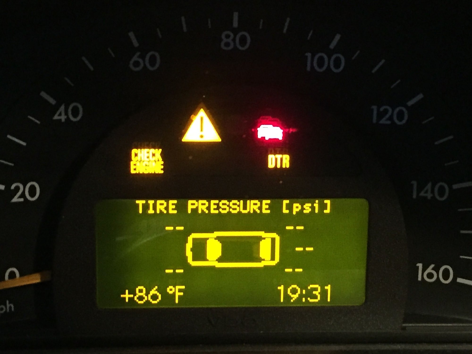

Any STAR DAS experts still around who know how to program the tire pressure loss function mod? I have a 2003 USA model C230 and have changed the following settings based on the information found on an old thread at
https://mbworld.org/forums/c-class-w203/452383-star-das-menu-paths-mods-pre-facelift-w203-3.html
  1. EZS Control Unit > Read Coding and Change if Necessary > Tire pressure loss warner (PRESENT)
  2. ICM Control Unit > Variant Coding > Special Equipment Coding > RDK tire pressure control (ACTIVE)
  3. However, I cannot find any tire pressure loss warner option under the ESP control unit.

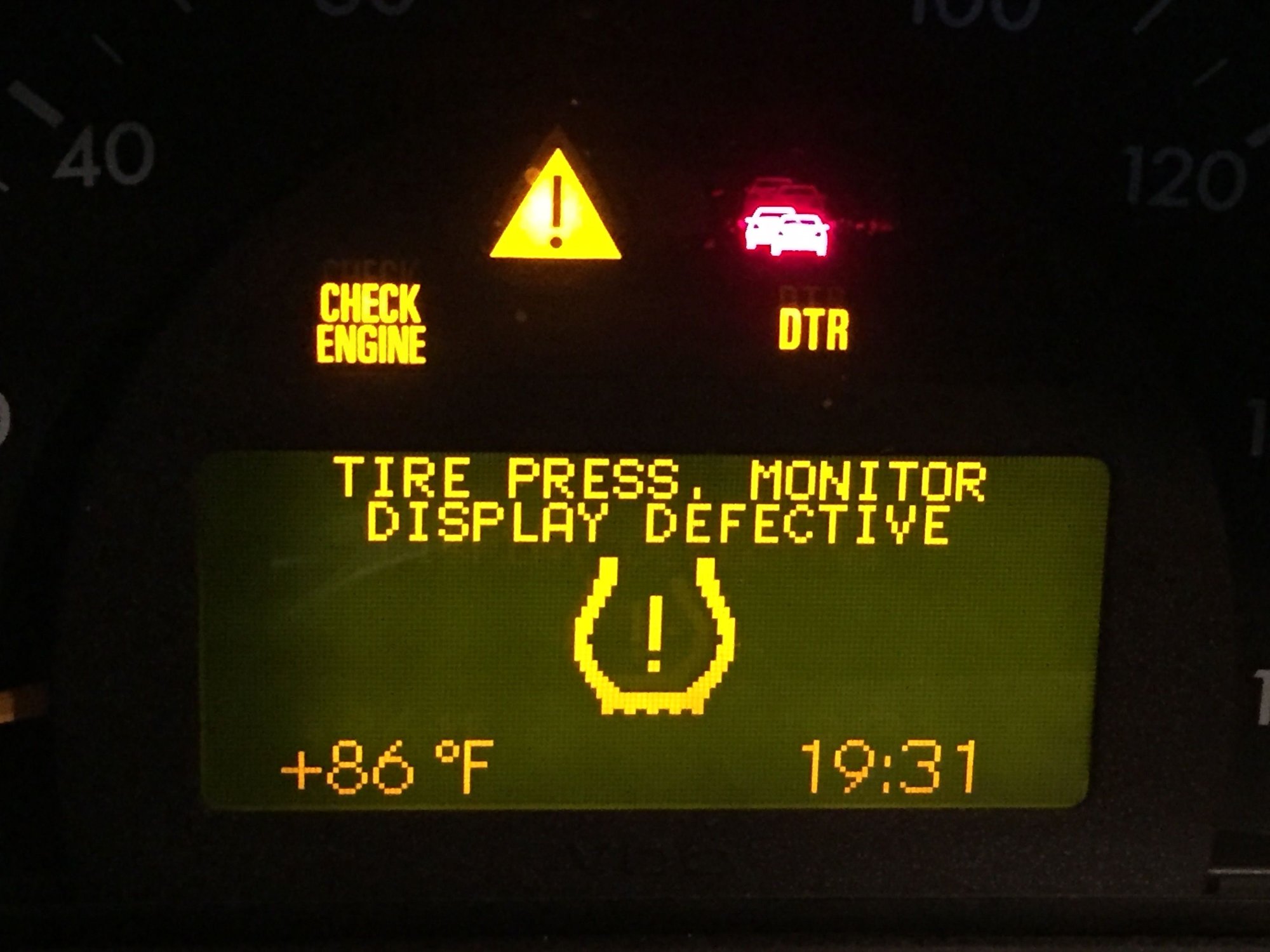

The "tire pressure (psi)" page is activated within the actual instrument cluster odometer menu, but the "error tire press. monitor display defective" also displays upon startup.
Thank-you!

My car is not equipped with any TPMS sensors. This mod is supposed to enable a feature that uses the ABS sensors to measure tire diameter by proxy, and trigger an alarm if one rotates faster than the other. Not as good as a sensor based system of course but it does work. I believe it is an old Canadian market feature, but not DOT approved for the US. But your comment makes me re-think about activating the RDK tire pressure control in STAR. Probably not the right setting to change in my case.

No luck with the current settings! I under inflated one tire by about 15 psi, and drove around a few minutes earlier today. Unfortunately no warning came up on the dashboard. Wondering what model year this feature was first introduced? I must either be missing another setting, or my ECU version is too old.
