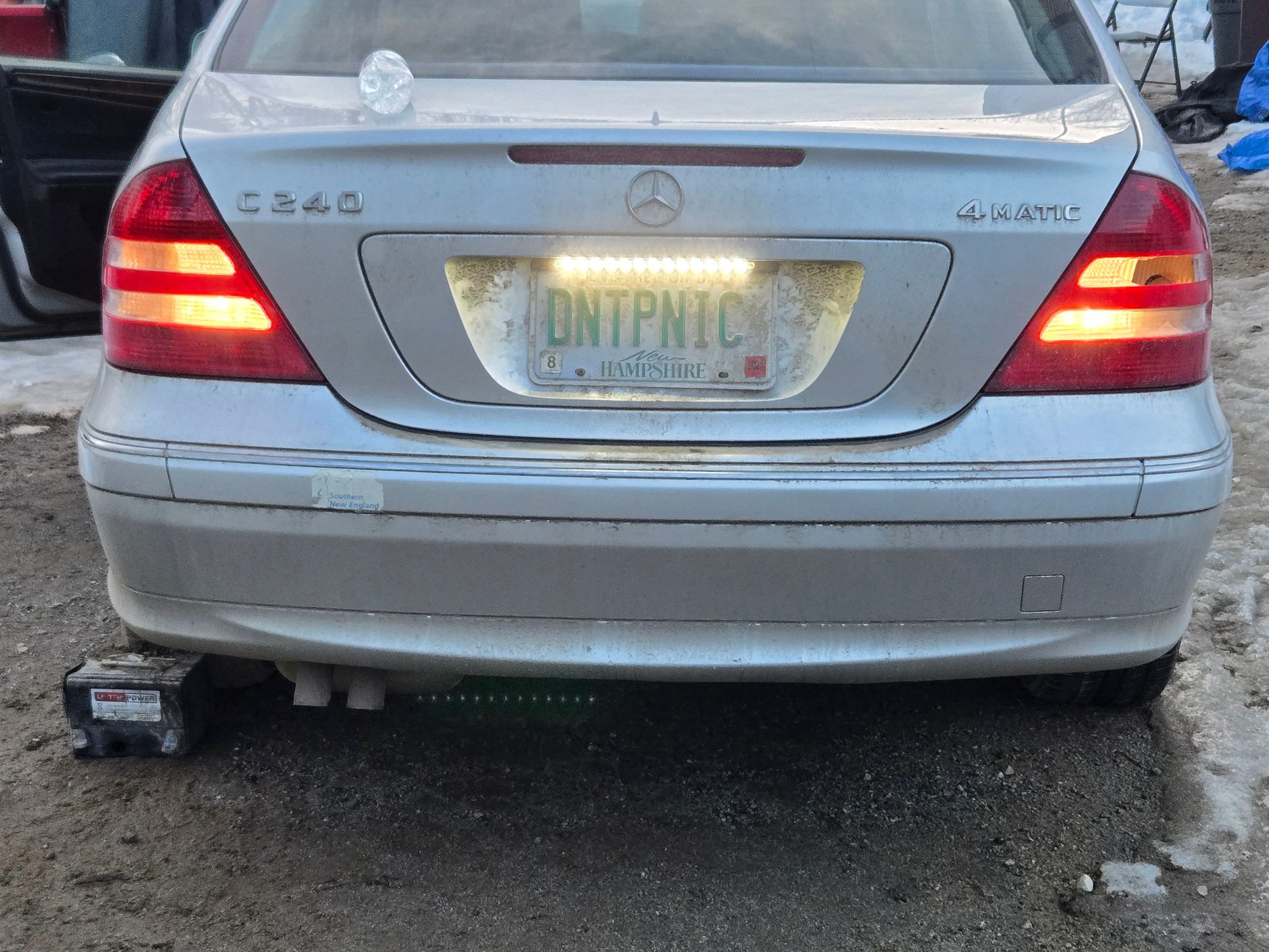

https://www.vleds.com/lp-reverse-universal.html
LPR REVERSE LIGHT BAR + UNIVERSAL HARNESS - CAR TRUCK SUV KIT

So it mounts on the license plate frame?

yup, then just tap the reverse light, they're leds.

Here ya go!! FINALLY had time to install. Yes, the right tail is broken, jackass parking lot hit. Being replaced tomorrow.
I also live on a dirt road, so chill. Lol
