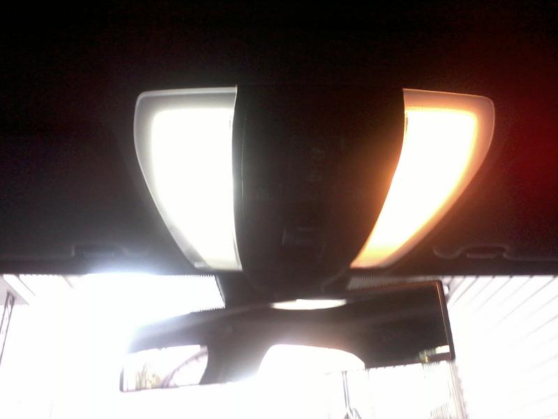

I just opened both the front and back to see if I can swap the bulbs to LED. I attached a pic for reference, AZN LED on left and stock bulb on the right. Now I need to order more LEDs and change all of them.
