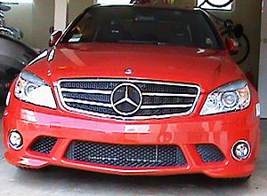

I change the front bumper of my C350 with the C63, I like to know if another person did the same, I change too the rear diffusor with four exhaust (two are fake) and paint in CF, my next step is change the piping of C63. Sorry the picture has poor quality, but I can show better picture as requested. The picture show an aftermarket grille, but was change with the original one.

I finished this project (Bumper C63) yesterday and was done in two weeks, the bumper is original MB C63,p/n:20488551259999, but was modified in each side, because is 1/2" more wide, the bumber has three foams, the center foam is the same of the C350, but the left and right was swap with C63, the bottom grille were replaced p/n:2048850553 2048850653 2048850453. The basic carrier was replaced p/n 2048852865.
The Foams Reinforcement were change left 2048850516 and rt 2048850616. The grille was replace two time, the only grille that fix is the original p/n:2048801083 lower, 2048800983 upper part and Stay for radiator grill 2048850336.
Diffusor P/n:2048854525, need two brackets for the installation lt. bracket 2048852314 and rt. bracket 2048852414. The diffusor was painted in Carbon Fiber, yes PAINTED. The roof or wing spoiler is aftermarked.
As you see, I spent many hours and try and error to find the correct parts to see a C350 as C63, but is the only one in the world. I share these quality)
Next step, replace the piping C63, sounds greate, I replaced in one C300, only small modification is necessary.information with everybody that want to do the same, without many hours in try and error, here I show you the receipt.
I will send more picture for details (but with better quality)
