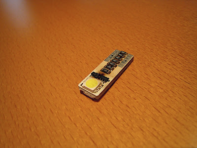

I have done some lighter testing now, the LED.s wont turn color at all if you leave the brows on without turning the engine on, the feed voltage is consistant at 11.9V.
However when turning the engine on, the voltage increases to ~12.9V, I measured the voltage directly after turning the engine on, and also after 10 minutes after the LED.s had turned blue, voltage was the same @ 12.9V.
My theory is that the slight over voltage (0.9-1V) causes the LED.s to overheat, when this happens something is causing the LED to change color.
This explains why the LED.s will stay blue for a while even if the car is turned off and brows left on.

I received by LED bulbs yesterday and installed them today.
They did turn blue after 10 minutes, but they were not as blue or purple as the bulbs from the other group buys.
I found a way of making the bulbs less blue, and it's really easy to do:
I took a yellow Sharpie marker and made a stripe (covering about 1/3 of the LED) down the middle. The yellow ink will better neutralize the blueness.
The result is a whiter light even after having it on for 10 minutes.
As the LED is very bright, I think you could even color half or even the entire LED with the yellow Sharpie to make it as white as you want. I will probably experiment with this later this week.
If you put too much yellow marker on the light, you could easily remove the ink with rubbing alcohol and a Q-tip.
I don't know if the marker on the LED will fade over time, but you could always reapply the yellow again.

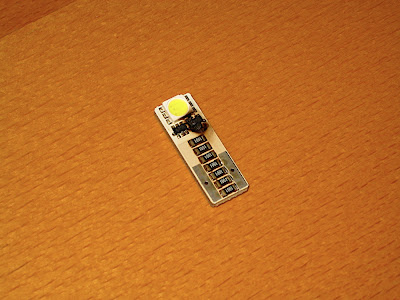

Knowing a lot about LED lighting in my field, LEDs are more efficient and work better the colder it is, but the hotter it gets the faster the LEDs will wear out or malfunction.
The issue with these LED bulbs is that it has a built in resistor, which is the primary source of the heat. You could use any kind of LED bulbs and install a resistor further down the wires so that it is not so close to the bulb. Also you could choose a resistor that will keep the voltage to less than 12v so that you won't have the changing color issue.
With that in mind I will probably leave the back covers off so that it is a little cooler -- water rarely gets back in there and I live in a dry climate.
