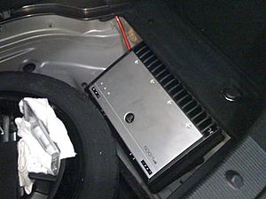

Here's mine, sorry about the bad pictures. JL Audio mono 500w mounted in what I think is the diesel European battery location. No holes drilled, made a templated that slid into the compartment. The sub is a W6 sealed as it fits perfectly, made a strap and used the OEM strapping loops. You could remove this system and there would not be a mark of the installation. Added this to a MM HK system. The car is so tight that the car actually pressurizes, the tump is wild however the pressure can hurt your hears.

I like ur set up and now questions, did you powered ur amp from ur battery ? How did u get the signal to the amp ? did u tapped from the stock sub ? and how about the remote wire ? where did u hooked it up to ? Sorry for 2many questions at one lol.

Ran power wire from the front Battery. Signal is a "high level" input to the amp taken from the rear sub, you actually tap into it at the stock rear amp. Turn on is an accessory signal taken at the rear power module. I set the amp level and just leave it, you could run a remote to the front if you want.

I get the first part but im still confused on the remote wire..what do you mean by that (highlighted) ? Can u be more specific ?

There are two types of remote. One is the remote turn on, just take an accessory signal from the rear power module to turn on the amp. The other is a remote bass adjust that is essentially a potentiometer you can mount up front to control the bass.
