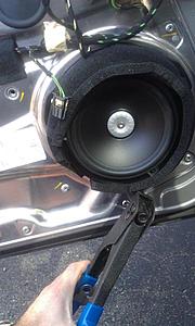

I was not going to go with the cutting out of the stock speaker route and do it custom. But in taking them out of the door and looking at them I can't help but use this method. It's so obvious once you look at them side by side that using the existing frame is the way to go. the fit is spot on.
and wow, what cheap crap these stockers are. Plastic frames! easier to cut I suppose.

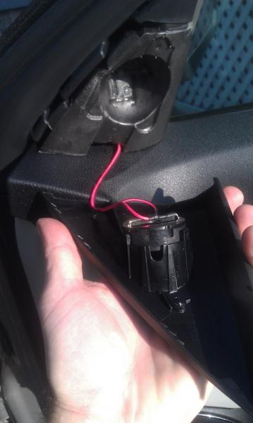

I purchased the Kappa 60.9's that askdrtodd had for sale in the classified section and had this excellent upgrade completed over the weekend - I ended up paying a professional to do the work, but walked through the install with him. Couple hours and $120 later and Scat01 is a very happy man...
I do have a tendency to overly appreciate enhancements (Sprint booster is the best performance mod on earth for the w204 for example), and this one is no exception - The clarity, crispness, separation, highs, lows, etc is just outstanding. I was another disappointed owner when it came to the audio 20 system, but have listened to music only since the install (sorry Stern)..
Couple pics - we found what is most likely the same "pocket" most used to mound the crossover into and the for the (massive) tweeters we fabbed up some brackets and hot glued them down nice and tight. (sorry for the bad pics, but you can get the idea)
Thanks for the great idea - really appreciate this one.

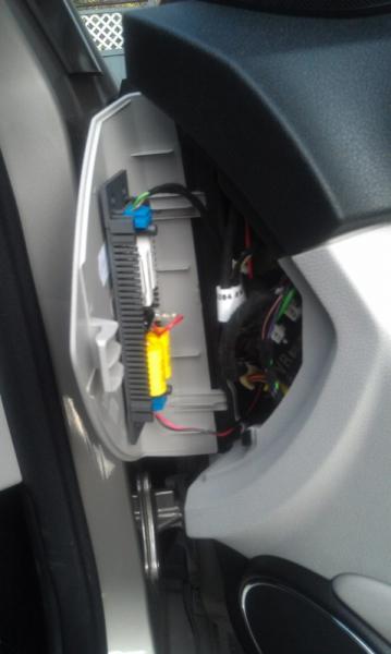

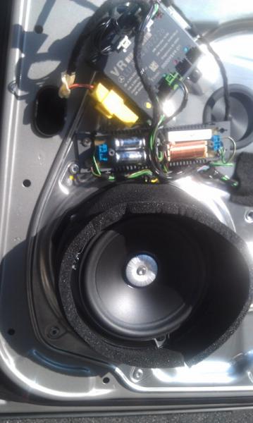

more pics of crossover spots and install tips
Here's some more pics of the install I did. The tweeter snaped right into the mount with the Bostons I used. I have two very large crossovers, one for each speaker in each door. So the woofer one I sheet metal screwed into the door above the woofer. The tweeter one is mounted in the access cover for the control box.
I soldered the wires back into the frame and reused the original speaker plug in my wiring and re-riveted the speaker to the door. All in all this method was excellent for the upgrade.
