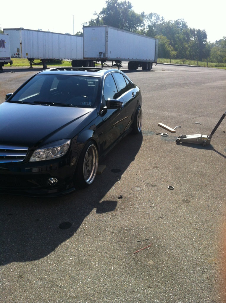

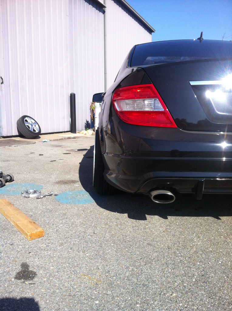

"Killing it" is very subjective. Coming from the Audi/VW scene most of what I see here isn't stance at all. Most MB guys aren't into stretch and poke and think it looks stupid. Personally I think square sidewalls and sunken offsets look stupid. Trying to stance a car on 20's just doesn't look right to me. If you are going to pull off the look as it was intended to look then 18" is the optimal wheel size to use. There are guys on here that everyone says are the "wheel fitment gurus" but all I see is flush fitment at best. In the interest of being true to the German tuner car look I think what you guys should shoot for is this look:
W204's and offsets of wheels-978ce92c-efd5-49bf-bef1-c45a2ebd7a31-14189-00000b59e0cf2916.jpg
W204's and offsets of wheels-3212f7e4-611a-4745-b130-d8ab16e5a8a4-14189-00000b59f609f06a.jpg
These are a friends wheels I tested for fitment before buying my new wheels. My car will look similar to this when I put my new Brabus IV on my car. This is what stretch and poke are supposed to look like. I don't consider myself a guru but I know my stuff when it comes to wheels, offsets and stretch.

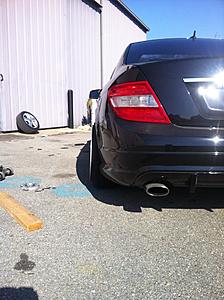

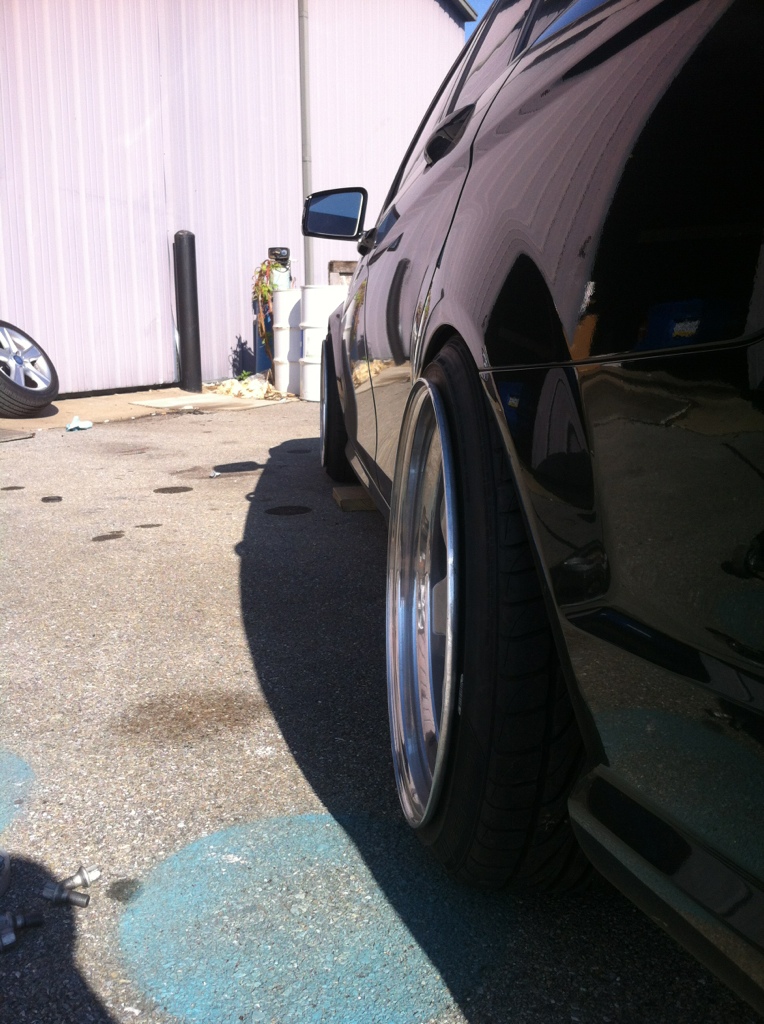

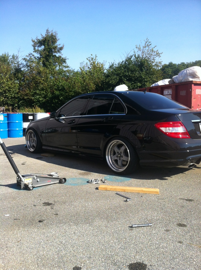

A few more incase you are interested:
W204's and offsets of wheels-c5b574f8-61bc-4d65-ab32-9e1a55e254ec-14189-00000b59da1a3d4a.jpg
W204's and offsets of wheels-79e8d772-fb7e-4eb0-afbd-ca156b10a63a-14189-00000b59d3f7a482.jpg
W204's and offsets of wheels-7c5f6179-091c-488c-9b3e-ffaeaef6ef44-14189-00000b59e6f9689c.jpg
W204's and offsets of wheels-3ae27a31-9e17-4142-8a16-66a10b5e9b55-14189-00000b59ecdfd404.jpg
