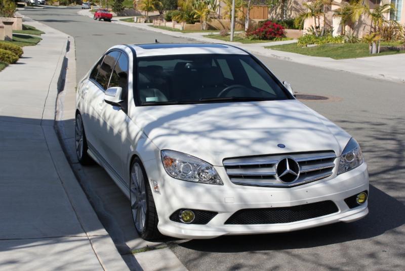

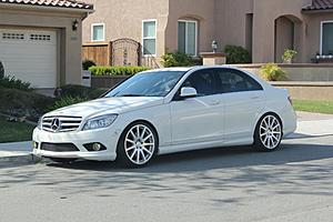

Kleemann MS-11 wheels
19x8.5, +45 (non-staggered)
Tires are 235-35-19
Lowered on H&R Supersports
Attached Thumbnails W204's and offsets of wheels-1.jpg   W204's and offsets of wheels-2.jpg
Old Mar 9, 2012 | 06:57 PM
  #446
silversx's Avatar
Joined: Feb 2012
Posts: 163
2009 Evo X 420 AWHP, 2012 C250 Sedan
