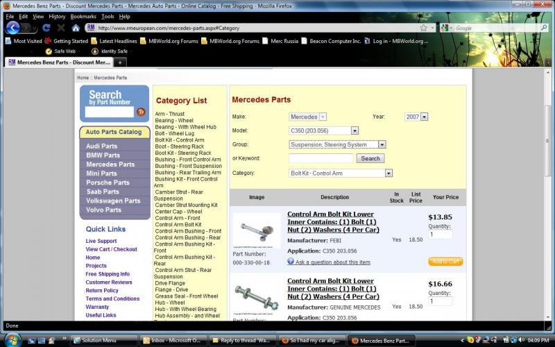

Bolts cost $13 to $16 each at RMeuropean depending on whether you want Febi or genuine. They are a rip off outside the US.

Thanks Glyn! I think I'll look into this then! I've RMEuropean trying to find them now. I'll have a word with my SA about installing em. Hopefully labor charges won't be ridiculous. But from the pictures you posted I'm guessing I need quite a few things per wheel. Hate to ask you ask you've already been so helpful but do you have a part number or link to the bolts on the website? I can't quite find them...unless I'm looking in the wrong category.. (I would assume they would be under "suspension, steering system")
Old Jul 21, 2011 | 10:22 AM
Glyn M Ruck's Avatar
Super Moderator
Joined: Jun 2008
Posts: 19,942
Likes: 192
I have quoted W203 bolts. The bushes are interchangeable between 203 & 204 so I'm presuming the bolts are as well - tell RMeuropean to check this but if you look at the part number it is multi model. I don't know why they don't list them under the W204.
These bloody bolts cost $142 a pair in SA
Attached Thumbnails So I had my car aligned, but....-rmeuropean-fluted-bolts.jpg

Thanks for the reply Glyn! I just send RMEuropean the inquiry. Wow that's quite the markup! I thought it was bad over here in the states D:
