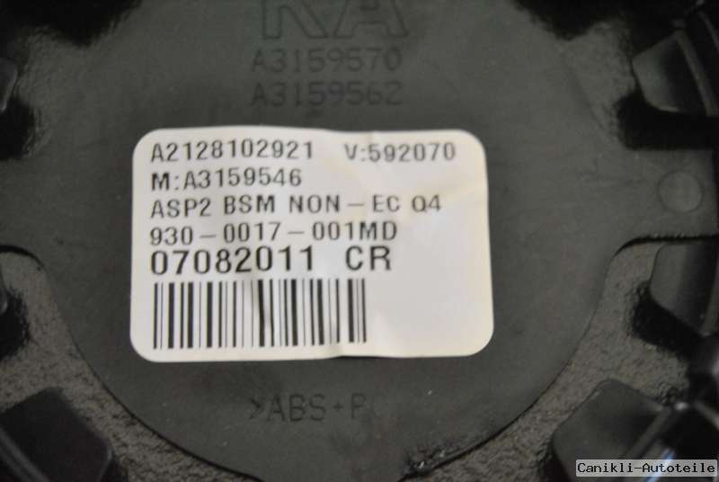

Hello,
Can anyone indicate if it's possible and possibly how to retrofit Blind Spot Assist on a w204 (2011 facelift)?
It seems that some settings in the engineering menu have to be done.
Is the necessary plug availalbe in "non blind assist" model (mine aren't even elechtrochrom)?
Front:
Back:
Model nr:
Thank you

It's a lot more than just the mirrors. There's all of the wiring, the sensors in the rear bumper/sides, the controller - etc.

Blind spot assist can be retrofit on 2009 to latest model.Needs to be replaced right and left rear view mirror assembly with rear view mirror glass, right and left door control module and right and left rear bumper reader sensor and wiring harness and needs to be upgrade wiring harness to rear can and needs SCN coding to be activated the system on the instrument panel and central gateway.Any question email @ gnnmotors@aol.com
