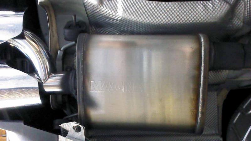

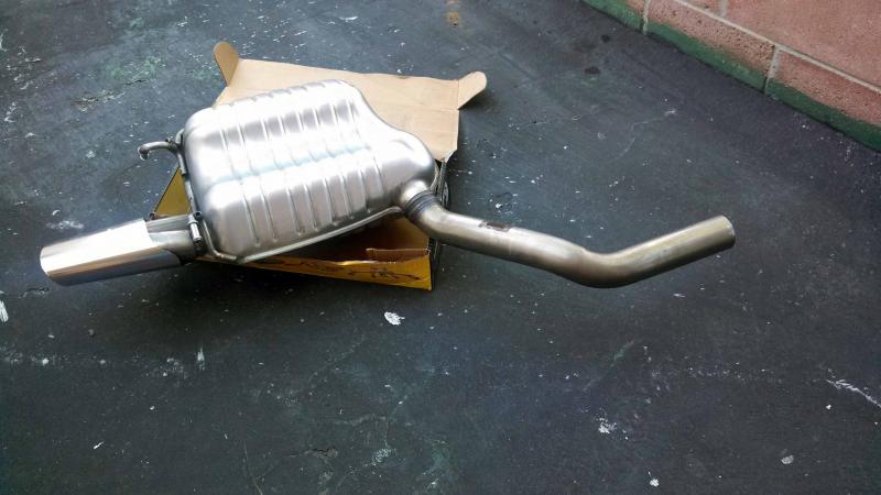

I modded wife's c250 exhaust to AMG Quad tips. Since we both hate to drive noisy cars, I installed a Y pipe after the resonator and Magnaflow 11365 muffler on each side. Exhaust sound is a little louder than the stock but have to live with it.
If I have to do it again, I will get original C300 Muffler. You don't have to remove the original Muffler to install AMG Quad tips. Provided you have the h type. The original C250 muffler have two pipes coming out. No way to mount the AMG Quad tips into.
