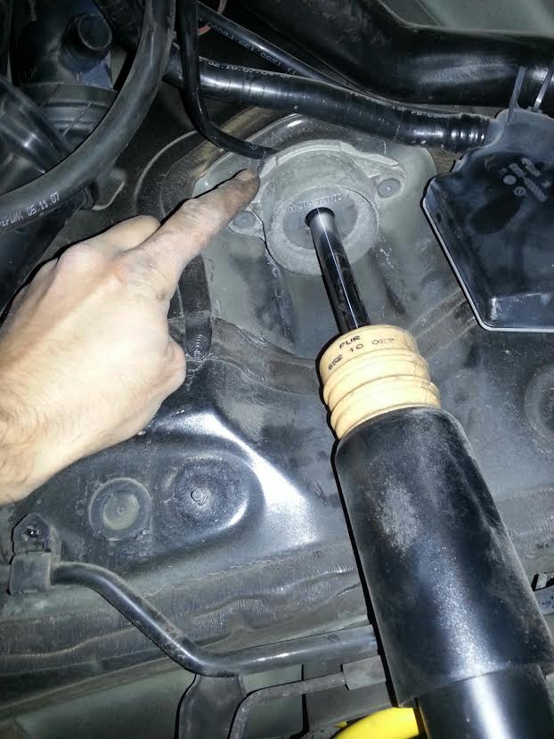

Turns out when I installed the coilovers, one of the struts took off a hose off the gas tank. Now I need a new gas tank, which the warranty won't cover as it's my fault.
A word of advice for everyone installing coilovers...watch the hoses! They aren't replaceable, you will need a whole new gas tank.
2632.82 quoted to me for parts and labor.
Im so disappointed in myself right now. Won't be done till Thursday at the latest...

Rules Lawyer - This has happened to another member here on this forum in the C63 section. He glued his hose back onto the fuel tank, as it's designed to be part of the fuel tank and not removable or replaceable. The design is crappy I agree with him. The area I live, I really do not trust indie shops. The Mercedes dealership in Austin has always been good to me, upfront and honest. I have no reason not to trust them, they even sent me a pick of the screw up.
NOTE TO Everyone, make sure when you install the struts, the hose is NOT in the way. Such a simple mistake on my behalf cost me 2632 in parts and labor.
Glyn M Ruck - Thank you for your kind words, and for all of the suggestions. It hurts to know my simple screw up cost me so much money, but there's nothing much I can do at this point but to take it and learn. No sense in crying over spoiled milk.

Got Sadie back today, and everything looks good and drives good so far. They replaced the gas tank, I can tell when i poured gas in, they only filled it half way...and under the gas cap there is some sort of marker paint on one side I guess for directional installation purposes. By taking a look at the picture in my previous post, anyone know what that hose goes too?
