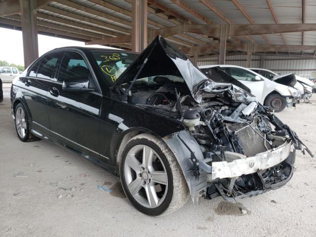

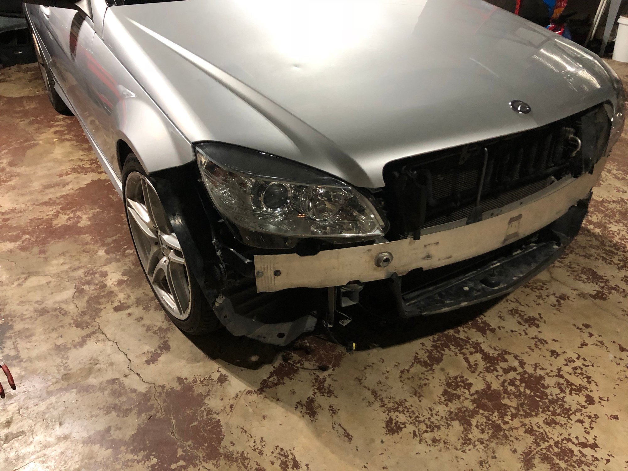

Take a look at this one, the mileage is extremely low and I couldnt pass this one up at auction so I helped a family member buy this one. The first two pictures are from auction, I know salvage vehicles can be a polarizing subject but entertaining as well. So what do you all think? Would you ever buy a salvage vehicle and if so would you ever consider this one? If you wouldn't normally buy a salvage vehicle would you make an exception for one with such low mileage? It can be difficult if not impossible to know the full extent of the damage from pictures but for fun why not make some guesses, how bad do you guys think the damage is?

I had significantly less damage to that same area in my W212 (which is really similar to the W204 in terms of part sharing) and the total cost to repair was $12,000. With the other issues the early W204s are known for, I would have let this one RIP.
But it should be interesting to follow your progress. Keep us posted.

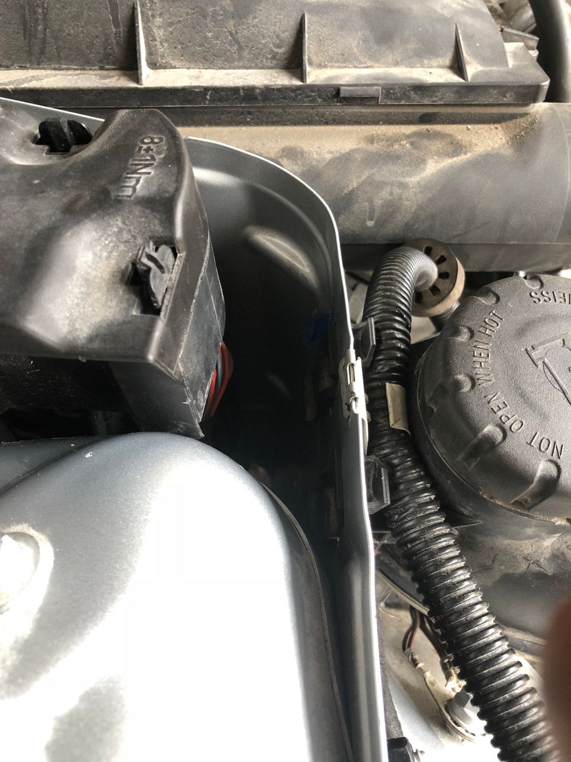

Wow that is quite an expensive repair. The front end of newer vehicles have a lot of parts and pieces that can really add up quickly, especially paint work which is tedious and expensive as well. Do you have any pictures or additional details to share by chance?
The car above was listed as a run and drive at the auction but when it was delivered it was very hard starting and ran rough. Upon closer inspection there were a few engine plugs for the cam magnet and sensors that were damaged. Once the plugs were replaced, one wire repaired, a cam magnet and sensor replaced it started up and ran perfectly smooth.

I don't buy salvage vehicles, and likely never will.
How do the doors open and close, all four of them?
The replaceable parts are not the thing to be cautious about. Also not the electronics. Those things have high probability solutions.
The mystery that can never be known unless you have a frame fixture, or after you rebuild it, is whether or not the body in white is bent. If it's bent, even if you attempt to straighten it, it will never be the same again.

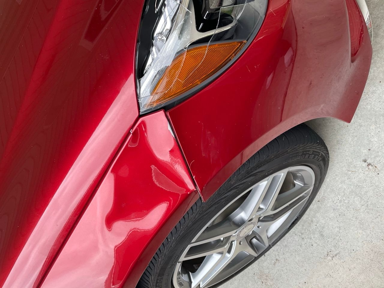

Now, granted, the headlight itself was $2600. But this damage seems extremely minor in comparison. Nothing structural or mechanical was involved, and the damage ended at the front passenger door (so it wasn't like it was damaged all down the side) and the door was repaired, not replaced.
Total cost to repair: $11,775

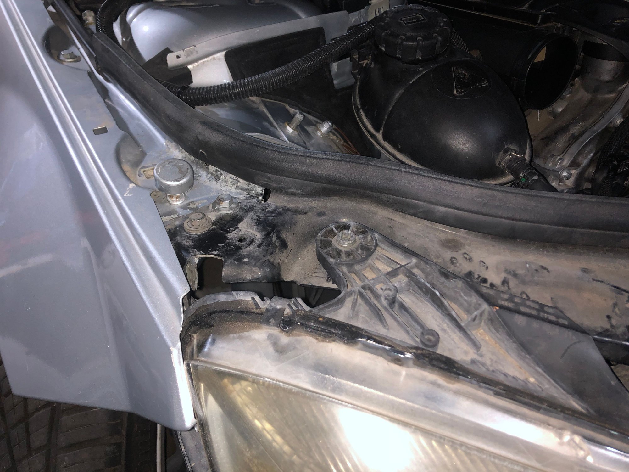

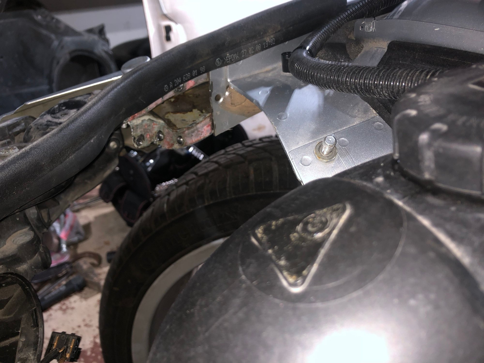

Here is another angle of the damage. The only metal to repair are the tip of the fender apron, the bracket right above where the aluminum frame extension goes into the steel frame rail, the area where the coolant bottle mounts.

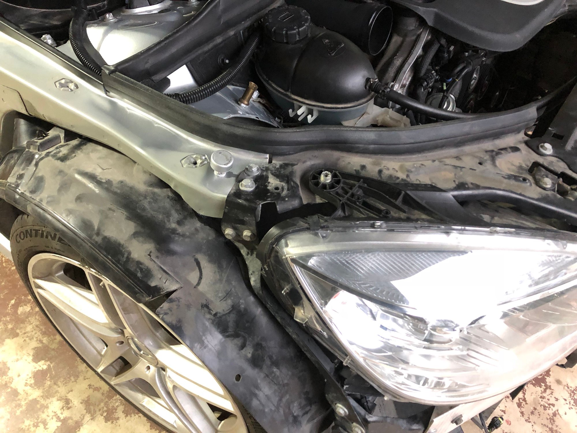

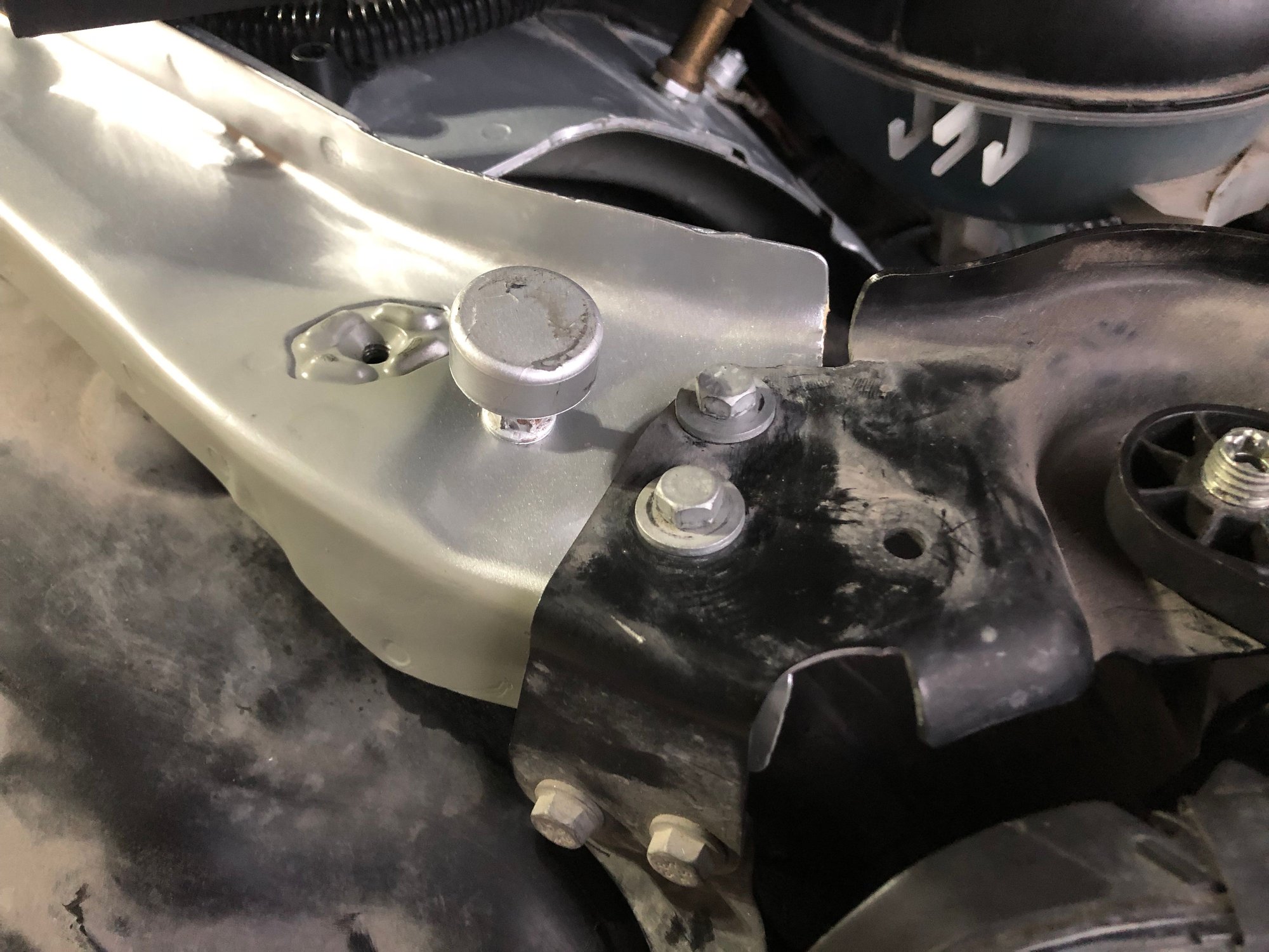

All of these areas are just a single layer of sheet metal except the apron and are pretty easy to correct. The fender apron was a little more challenging but still fairly easy, with a slight pull and some careful hammer and dolly work it was all in the correct shape except the forward most fender hole and hood bumper were slightly depressed so a small access area was created by drilling about 5 spot welds and making the least invasive cut possible the inside layer of metal (it needed slight straightening anyways) and allowed the fender bolt/hood bumper to be pushed up into the correct position. I am very happy with the access area as it is super minimal and can be neatly welded. 3 pieces of sheet metal make up the fender apron and the two more substantial curved/stamped pieces of the apron on the outside were left perfectly intact. Cavity wax was thoroughly sprayed on the inside after welding to prevent future corrosion. The 3rd photo is after straightening the apron and the 4th is of the access area

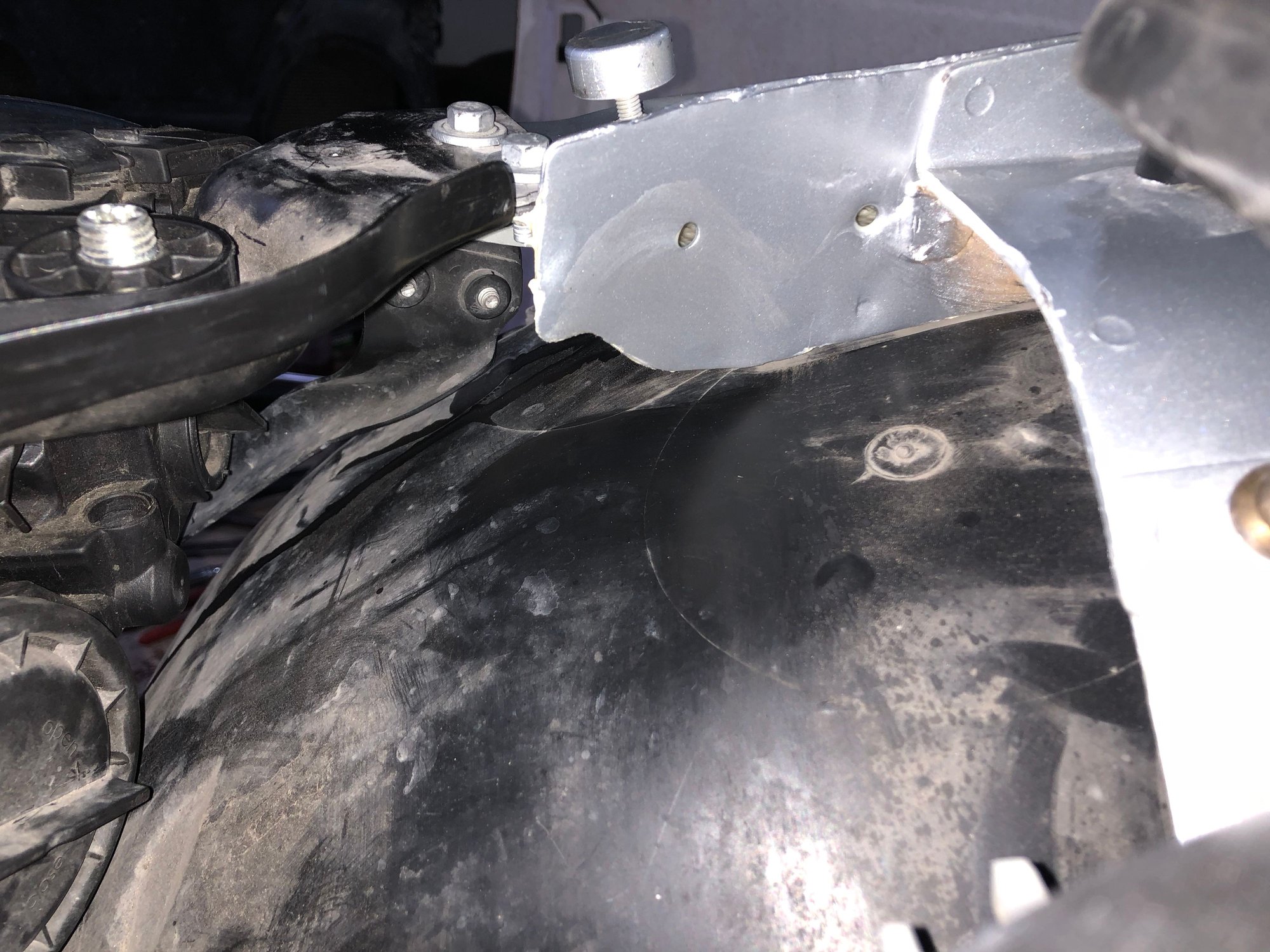

This is after welding and paint touch up. seam sealer was reapplied on the bottom edge like from factory, and the light green primer was touched up with the perfect color matching paint and the apron was sprayed with top of the line ppg base coat and a single layer of clear. The fender holes on the new fender line up almost perfectly with the original paint markings around the bolts of the car it came off of. The core support bolts at the tip of the apron line up great as well. The 4th picture you can see the rest of the apron is untouched and original

I just got the car back and the final total was $13,504. They replaced the bumper, fender, grille, illuminated star, passenger power folding mirror assembly and glass, the entire passenger headlight assembly and the control modules for both headlights, and the windshield. It was $10,000 in parts and $3,500 for the rest.
Big ticket items:
$1660 - OE aluminum hood
$1200 - OE windshield
$985 - OE power folding mirror w/blind spot assist
$300 - OE illuminated star
$2651 - OE RT headlight & modules
$905 - OE LT headlight control modules & programming
So yeah, not the same thing as your project which looks like it is coming along well. But my car had no hidden damage and nothing mechanical was touched.
