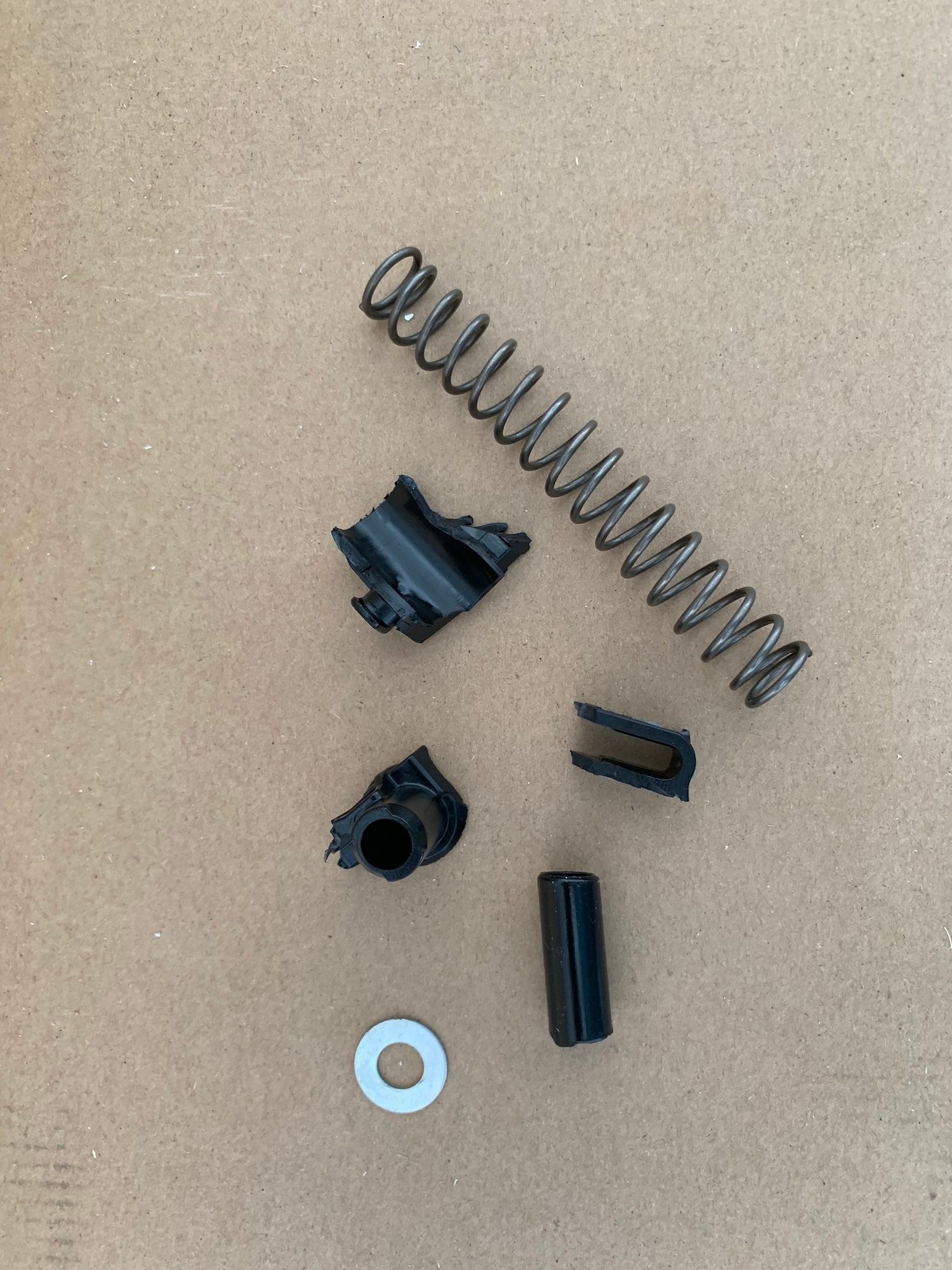

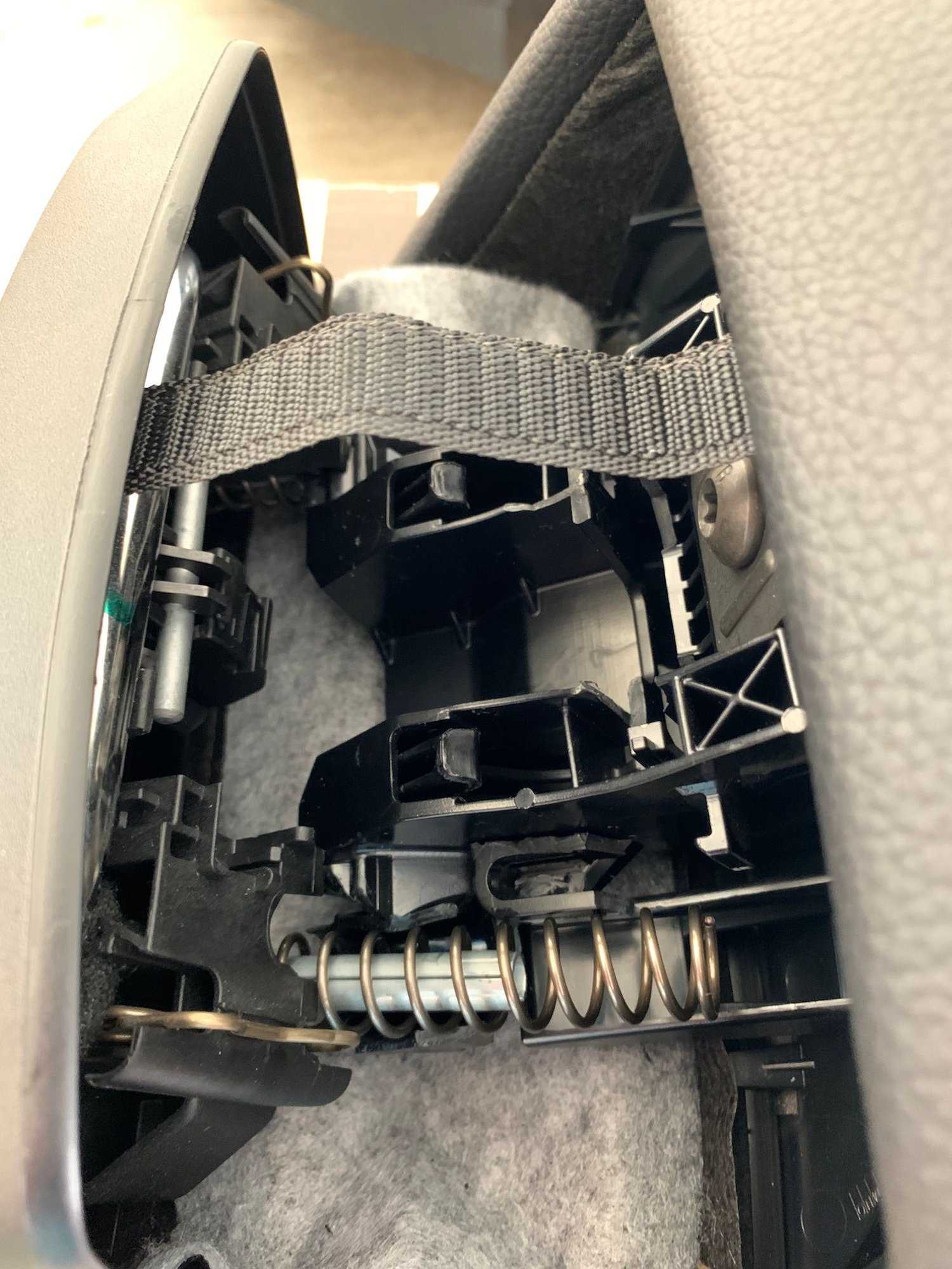

I"m not positive but I believe these are one-time use. My driver's side headrest popped out by itself (I suspect age & heat) and part of the plastic mechanism breaks off when it deploys. If I remember correctly, the headrest hooks in at the bottom then pushes up and hooks to the lip on the top. The pictures show the headrest internals and the broken parts. I have mine just hooked back into place currently.
Thank you.
Interesting, I do not see a big spring like shown in your pictures. Guess the body shop who will be fixing the car may have to address this with the dealer.
The headrest comes as one piece. The electrical wire passes down through one of the headrest guides and plugs into the SRS behind the panel on the seat back. The part is fairly inexpensive (< $200).

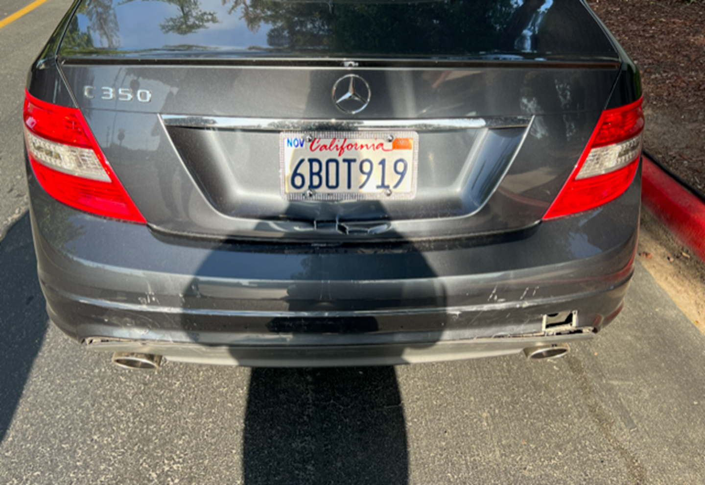

You could get a new rear bumper for about 300, diffuser 100, and a used trunk for around 500. Add about 500 for paint. Everything is very easy to install yourself,
I suppose it's just a matter of whether you are ok fronting the work.
You can try and prevent them from totaling it, take the cash and do the repairs, or you can let them total it (more money) buy it back, but then you will have a salvage title (might not matter to you, but will need to be inspected for rebuilt title)
As far as that m271 engine you can go ahead and search on here. Sure, there's plenty that have fine experiences. But those 4 cylinders have exponentially more problems than the 6 cyl models.
