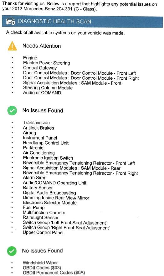

Old Aug 24, 2024 | 07:08 AM
Sharpy24's Avatar
Joined: Aug 2024
Posts: 11
From: Northumberland
C180 Coupe 2012 Petrol
Launch report
Old Aug 24, 2024 | 03:49 PM
CaliBenzDriver's Avatar
Joined: Apr 2019
Posts: 11,922
Likes: 6,775
From: Silicon Valley
W212 MY'14 M276-3.5NA @75kMi
Being Empowered...
using your new scanner, you can easily drill down into the crankshaft sensor fault to see what else can be involved... like coolant leaking onto sensor connector sort of things.
While booking your car at the front desk, request to have camshaft position sensors checked for oil contamination.
