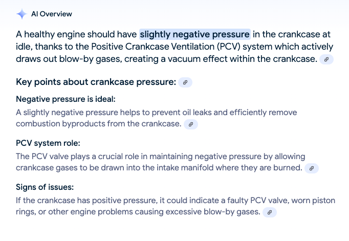

Awesome thanks. Also if you don't mind can you check if your car has vacuum on the oil cap? I just wanted to see if that was normal or if there's something wrong with my pcv system. Thanks!!

I will. Found this as well. Seems you are OK.
