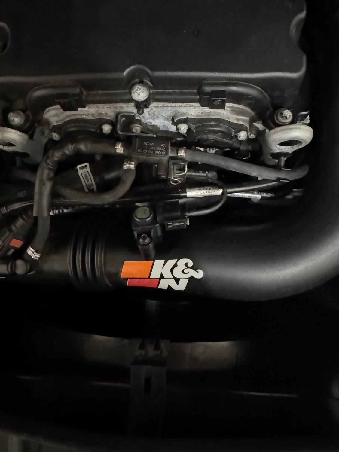

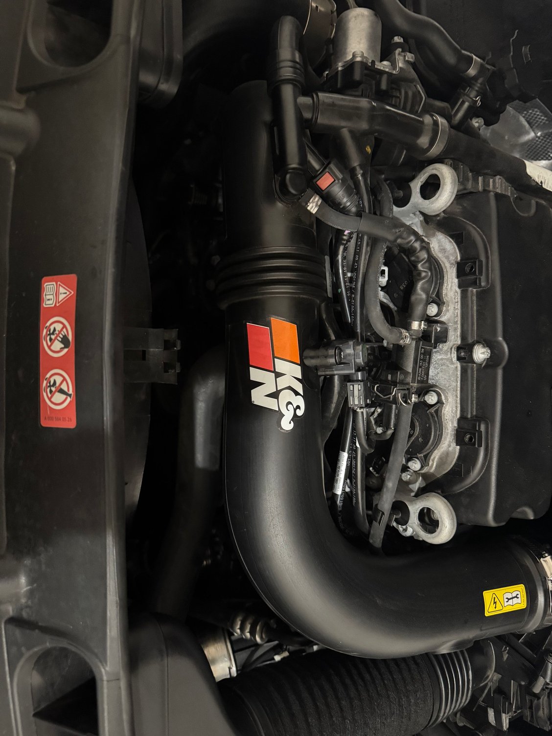

here’s a picture of the top end

I dont see it there... only turbo boost control solenoid.
I am not sure you can have both turbo + exhaust air injection.
Double check... you are after air pressure that should not be in the intake....turbo solenoid is very qualified to mess that up.
Hey@windoge , that is your MAF/boost pressure sensor on the intake pipe.
The MAP is the one underneath that that's literally inside the intake manifold.
I had this issue come up over a year ago. You will want to be sure to use genuine OEM/MERCEDES sensors. I purchased them off eBay and one from my local MB dealer.
You did say you replaced your throttle body? There is a gasket inbetween the throttle body and intake manifold, did that get damaged or shift while reinstalling the new throttle body? That will definitely cause a check engine lights/codes. If you lookup on YouTube this issue, "the flexx garage" posted a video about this.
Did you remove your intake manifold to put on the new throttle body? If so, did you replace the intake manifold gaskets ?
A smoke test would be good at this point to check for any leaks you can't see with visual inspection.
Double check your sensors are fully seated in the intake manifold and in the intake pipe.

are you talking about the one directly connected to to the throttle body pipe?
