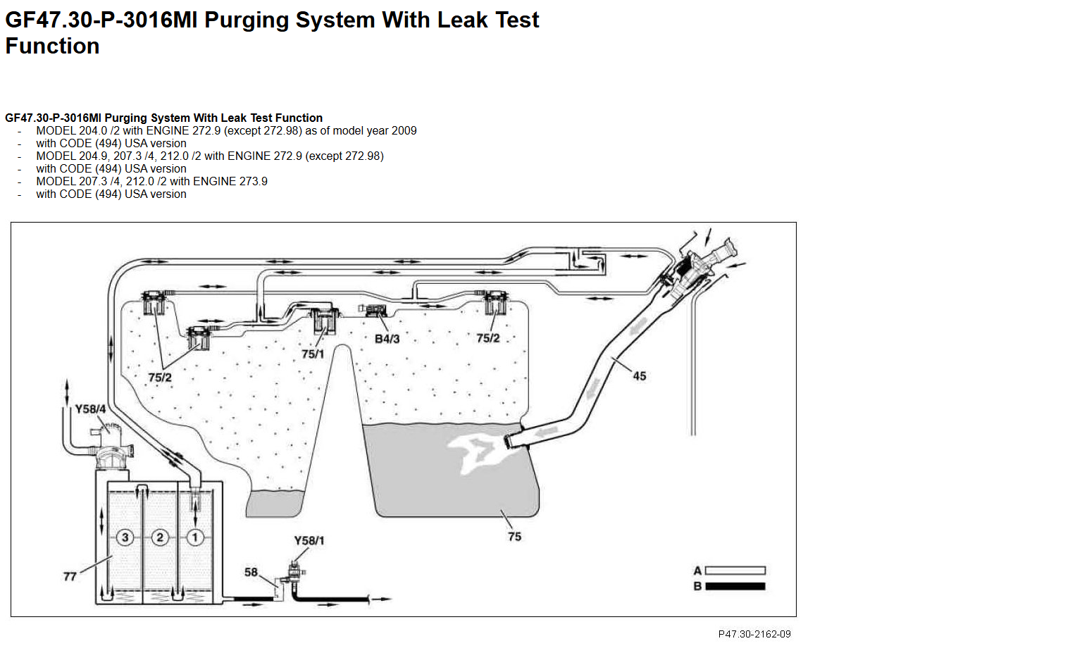

I had a check engine light before and it came with a code for the purge valve, it was a simple fix. I dont remember ever seeing the gas warning light ever coming on from it. The another time after getting gas a warning on the dash came on saying to check the gas cap, but it went away pretty quick and I dont think the check engine light ever came on from it.
I looked at the manual for that code and also checked how the car tests. Heres that page : https://charm.li/Mercedes%20Benz/201...st%20Function/
Im assuming you have the M272 engine.

Good catch on the fuel tank pressure sensor possibly going bad.
thanks for this information. Would check the fuel pressure sensor.
