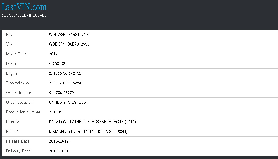

Is yours the M272 engine?
I tried to find test procedures for the P0002 error in XENTRY Simulation, but cannot. Sometimes you need to actually connect to your car and run diagnostics. XENTRY/DAS is really the best way to go if you are going to do your own diagnosis. XENTRY will walk you through all the troubleshooting steps. It is almost essential to have someone that knows what they are doing when using XENTRY.

BTW, your car is a 204.047. Your engine is an M271. Get your full datacard here: https://www.lastvin.com/vin/BPr5q2v3L07AXmxML
