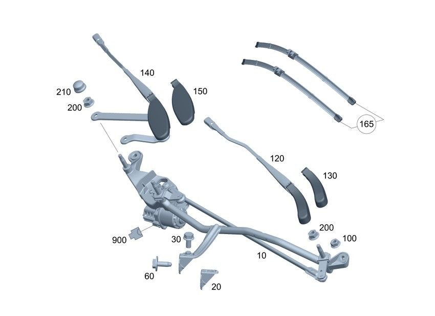

There is one motor for both wipers. Who ever did your windscreen did not properly re-connect your wiper linkages.

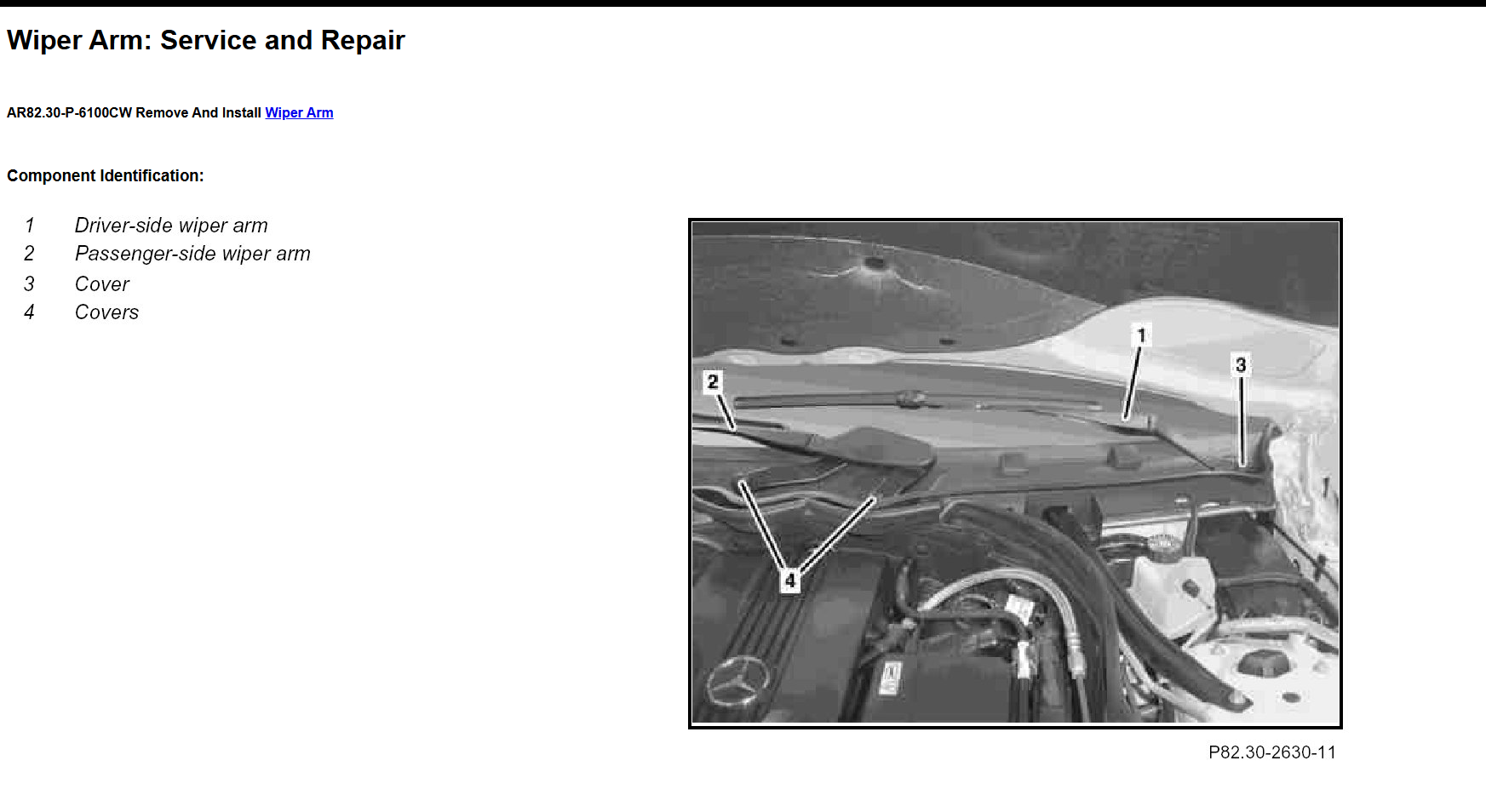

Could be something not tight enough...this is an image of what just about every MB does for wipers (variants of this). Something is loose. Probably the arm itself - you can take off the plastic shield and try a 14mm socket on it to check if it is tight.

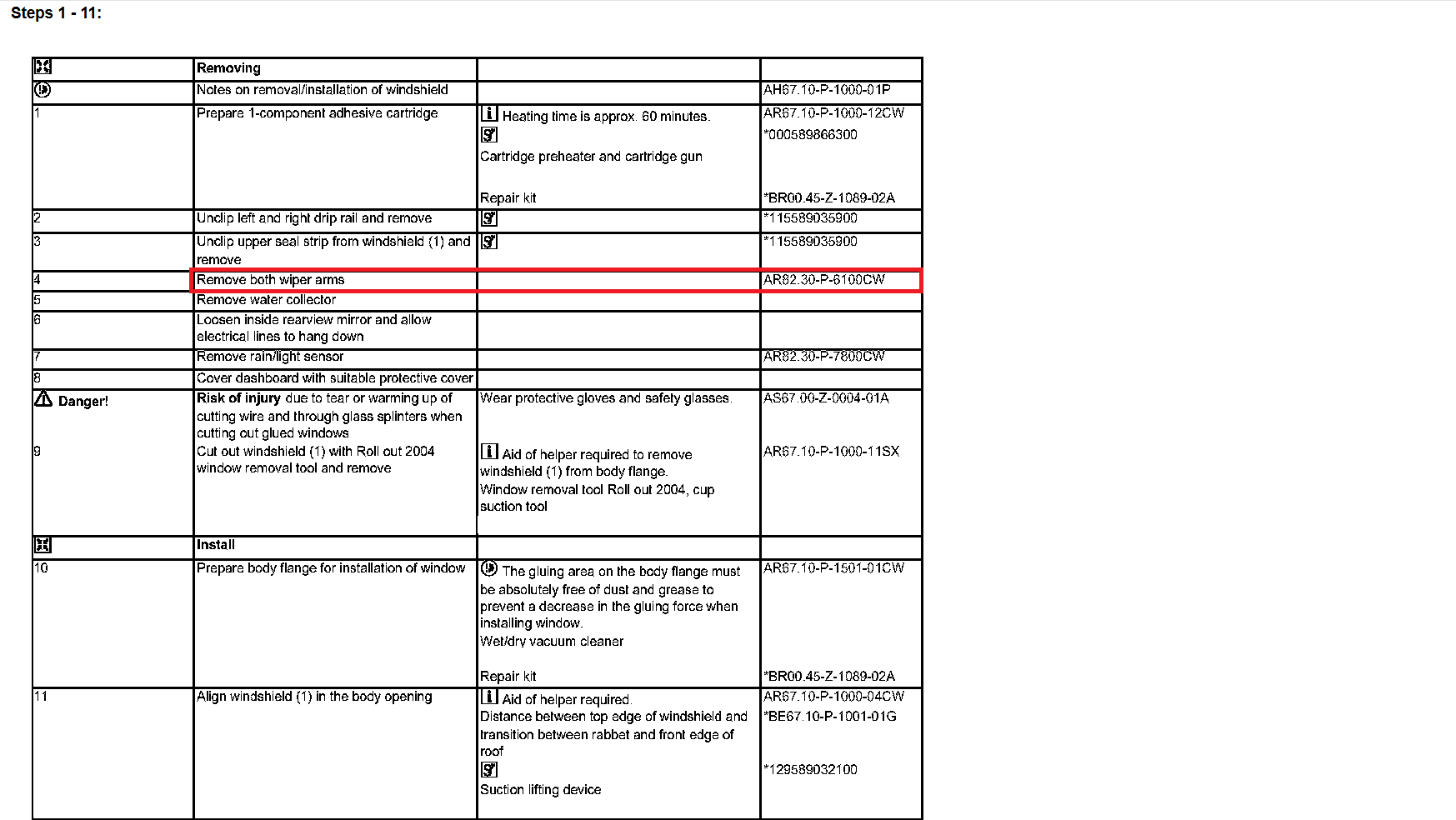

Did they remove the wiper arms? Im not sure what a windhshield replacement entails.
if they were removed they probably werent put back on properly. Have to go ahead and remove everything they worked on then reinstall it properly.

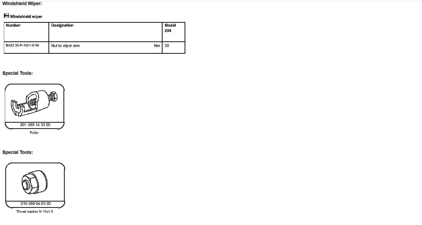

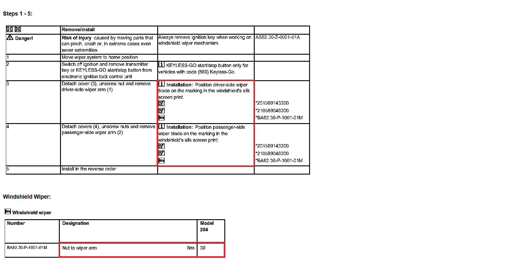

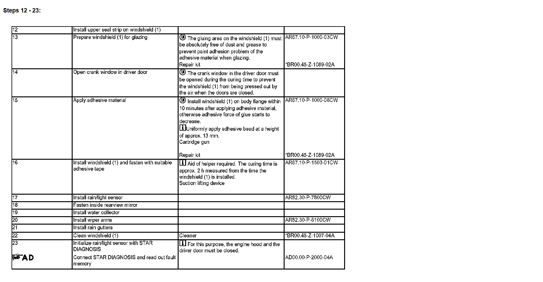

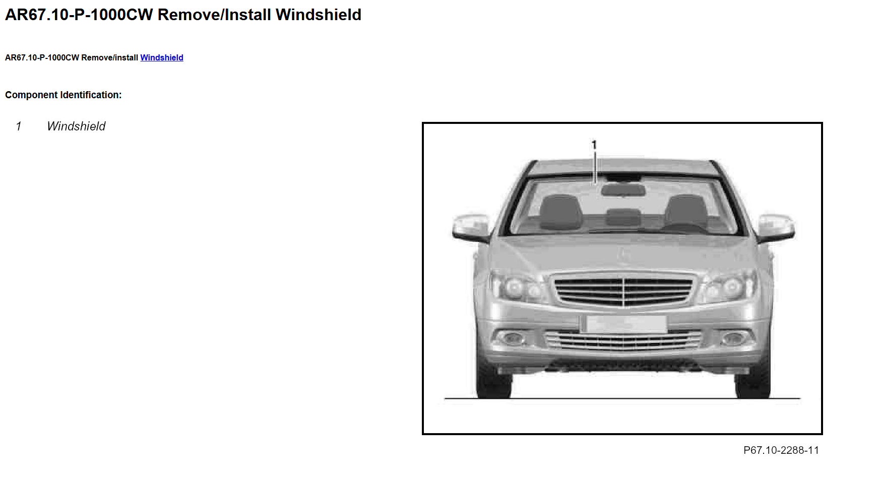

Lets see what the manual says:

It is going to be an untightened wiper arm.

Yep - you were right, whoever put the arm back on after changing the windscreen did not do the nut back up tight enough (the central one that drives the arm) and it kept lifting and has worn the grooves on the arm completely away, hence the slipping. New arm ordered but for now some electrical tape on it and tightened it up properly and its working ok
Many thanks for the help and image of what it looks like under there
