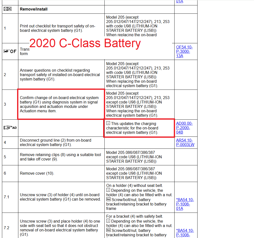

TimC300's Avatar
Joined: Aug 2023
Posts: 3,687

Old Apr 29, 2026 | 03:20 PM
Odd Piggy's Avatar
Joined: Sep 2013
Posts: 2,346
Likes: 692
2021 GLB250 FWD, 2023 GLA250 FWD, 2013 C250, 2015 GLK350, 2005 ML350SE, 2003 E320
That’s for the W205 SAM module initialization. I didn’t see anything like that on W/X204. Did I miss it for 10 years? We had a number of these.
W206 definitely has it as do H/X247, although reset on the 247s is a simple one step task.
Old Apr 29, 2026 | 03:31 PM
TimC300's Avatar
Joined: Aug 2023
Posts: 3,687
Likes: 1,107
From: MA Coast
Yes above is for W205.
For the earlier model W204 no battery registration is needed.
