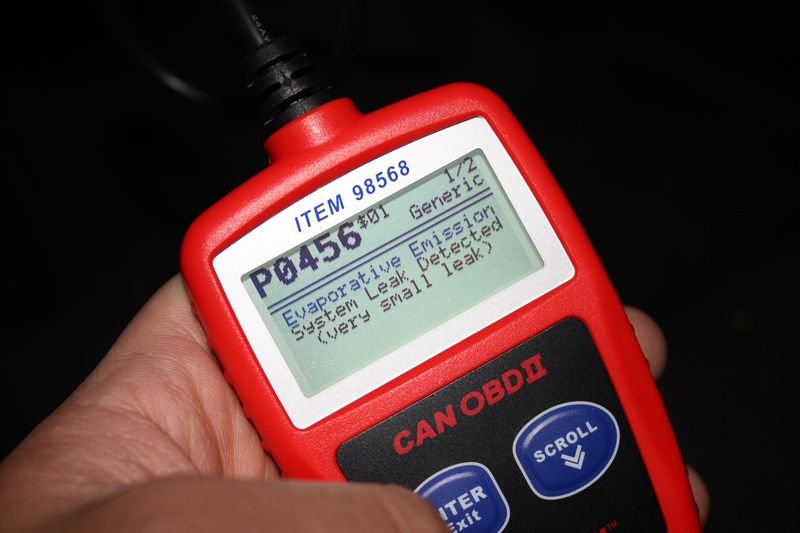

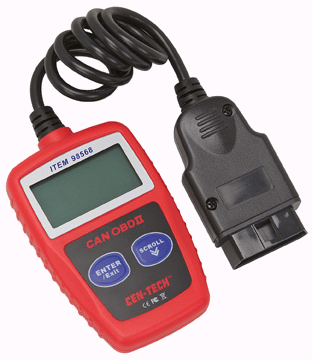

With a modern car I recommend that everone carry an OBDII scanner in the glove box. You can buy an expensive one but for Mr Average a $50 unit from Harbor Freight & the likes is all you need to put your mind at rest or alert you to a major problem. Just make sure you buy one suitable for European vehicles & that it tells you what the code means. It's a pain looking up codes.
This as all you need:
If you really want something more sophisticated:

You can clear codes & see if they come back. The OBDII plug is universal.
The 2 units I have recommended are the most commonly used on this board & have no issues with a Benz. I use the 3130 ~ there is a newer model out now.
Non of these readers is capable of reading Benz ABS codes or proprietary transmission codes.
