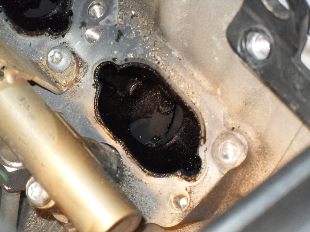

We have boroscoped a number of customer cars at my Benz dealership out of interest at various mileages and so far things look fine even with high miler B Classes. We had long discussions about this on the W204 forum when the M276 DI V6 engine was first launched & not a single problem reported. Benz & Ford seem to have the potential issue totally covered without the VW/Audi band aid. Benz has built DI Diesel engines for so long that they really know what they are doing.
Edit: & yes, fouled inlet valves have a marked effect on performance. It can get a lot worse than my Porsche picture. That was a low miler

I know all that. I've shown examples above. It's not an issue with Benz or Ford. They have managed the issue from grass routes design. The carbon does not get into the oil. It comes mainly from the oil/oil vapour & poor fuel in some areas of the world. It has no contact with the oil. It gets blown out of the exhaust which is why he correctly states that it could damage turbo charger vanes or cat converters if it comes off the inlet valves in big chunks. It does not increase oil consumption. It does not increase oil fouling/contamination. I've just retired from a global oil company job in which I had frequent contact with Benz & all OEM's. See my profile. My experience is not only South African. I was a long-term member of SAE until recently. This thread is about Benz cars & oil consumption. The only area where he & I might disagree marginally is that he ascribes most of the deposit to captive breathers. In our experience (& we have some of the largest research labs dotted around the world) that is the minor contributor with the major contributor being lack of oil control down the valve guides & VI Improver burn on to the valve tulip. The ratio would vary from one engine design to another.
The article does not disagree with anything I've said. I did not say the problem was confined to VW/Audi (VAG) Group & Porsche. I merely used them as an example & because I had pics of their problem & fix.
