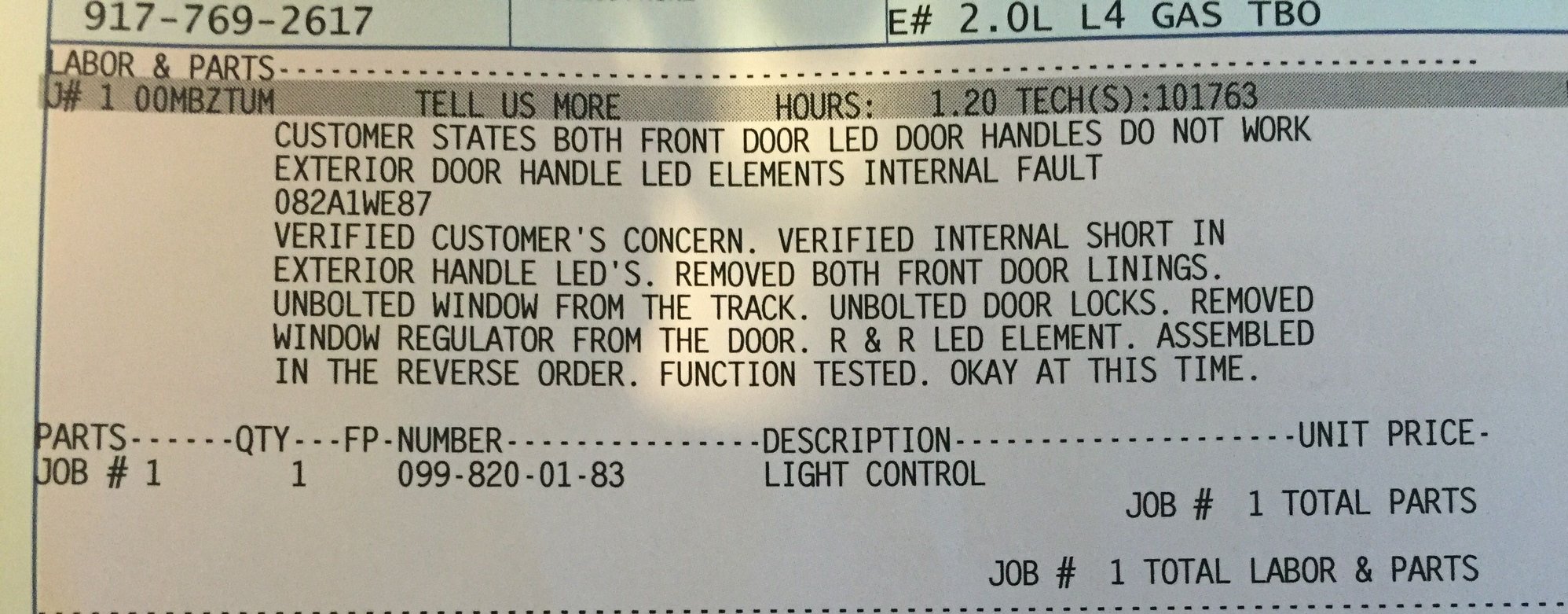

Old Jul 11, 2015 | 12:02 PM
  #30
benzboy429's Avatar
Joined: Feb 2015
Posts: 38
From: New York
2021 MB GLA 250 4Matic
Hoping this may help anyone with the LED issue, so far so good
