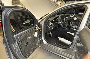

Just had all 4 doors Hushmatted as part of a stereo upgrade. No rattles and the doors sound solid when they close.
