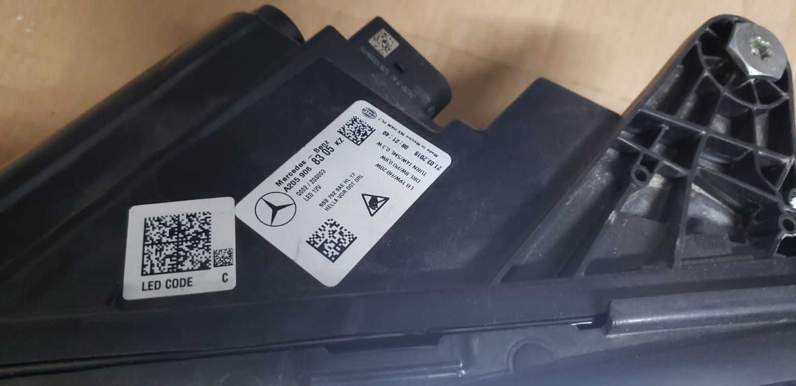

I have a 2016 C300 base model (halogen bulb) headlights and I got a 2019 LED/HID headlight but just the driver side (free so why not) can I use this? If yes I’ll buy the other side, here’s some picture of it.
also do I have to go to the dealer to get it programmed or a different harness etc

There are three options for this;
Option 1) Buy an aftermarket LED Headlight. Pros) Plug & play, Cons) Expensive, Quality ???.
Option 2) Buy a genuine LED Headlight. Pros) Good quality, Cons) Expensive, A lot of work to do.
Option 3) Buy a LED bulb. Pros) Cheap ($50) and plug & play, Cons) Same exterior look.
For option 2), you need genuine LED headlights (1 left & 1 right) ($500 used ~ $2,000 new), headlight control modules if not included in the headlights you purchased (2 left & 2 right) ($400 +/-), 205-768C wiring harness(about $200 +/-), Variant coding to "code 631/632 (static LED)" ($150~) (Option 1: Visit dealership, Option 2: Visit indy, Option 3: DIY (Xentry software, MB C4/C5 multiplexer, Windows labtop, MB SCN Login ID (rent onetime for $40 +/-), Knowledge(how to use Xentry software)).

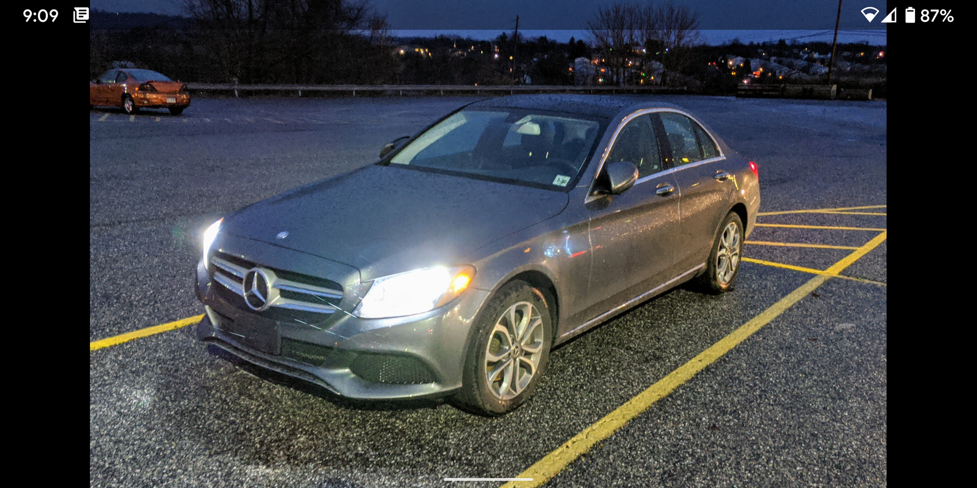

I bought these for my 2017 and they're fantastic. I replaced both the low and high beans and they are extremely bright and transform the car. It definitely helps make the car look more upscale and it blends together with the hue of the daytime running lights. Here is a picture and also see the link below for where I got them. No error codes, complete plug and play and have used them consistently for almost a year.
https://www.lasfit.com/products/2011...-bulbs-package
