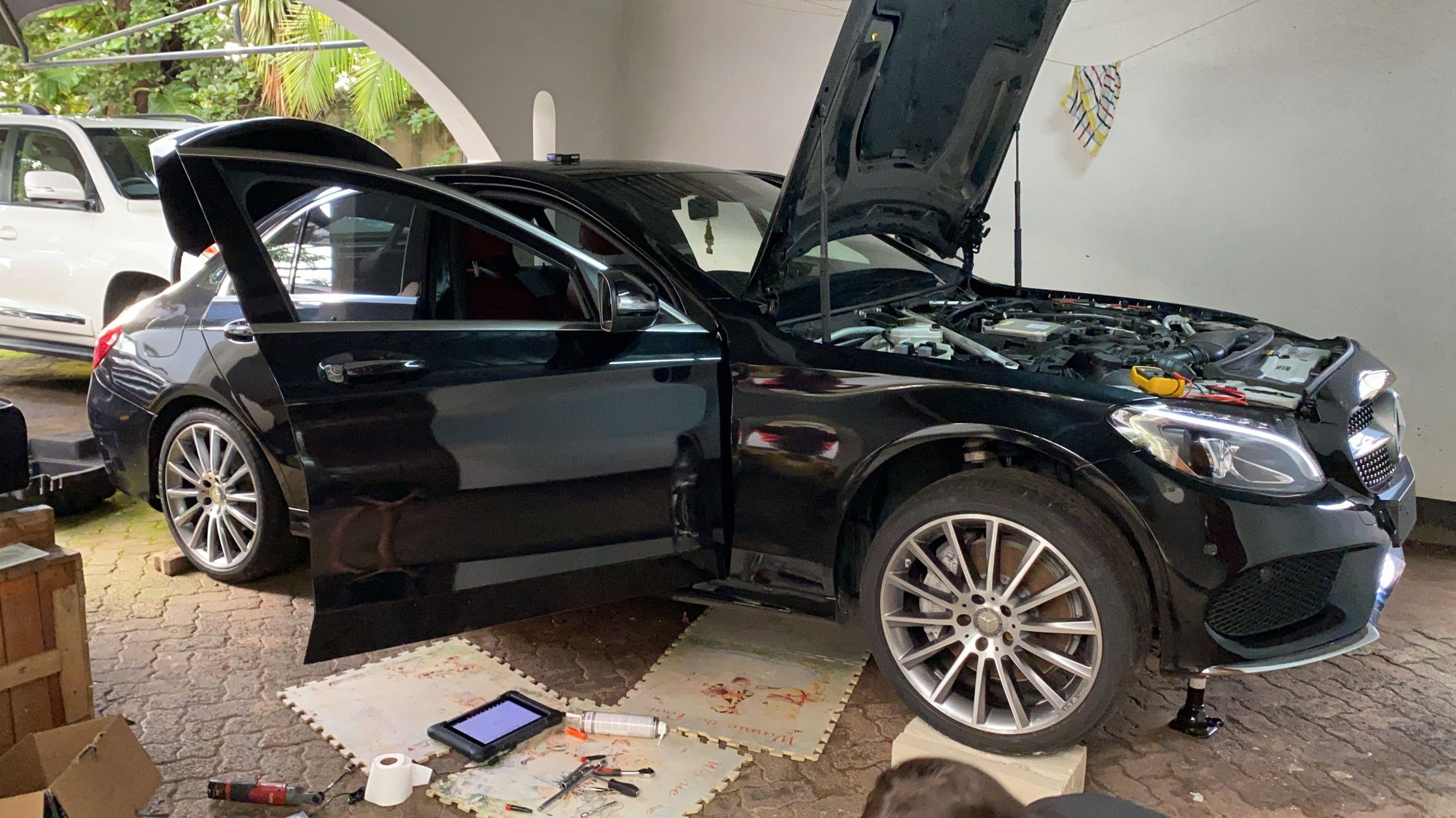

Welcome! Please post a photo of the C250.
Old Feb 23, 2020 | 03:37 AM
N444bss's Avatar
Joined: Feb 2020
Posts: 6
W205 C250 AMG Line Premium Plus
C250

welcome nice looking ride. Did you check the small battery in trunk for auxiliary?
