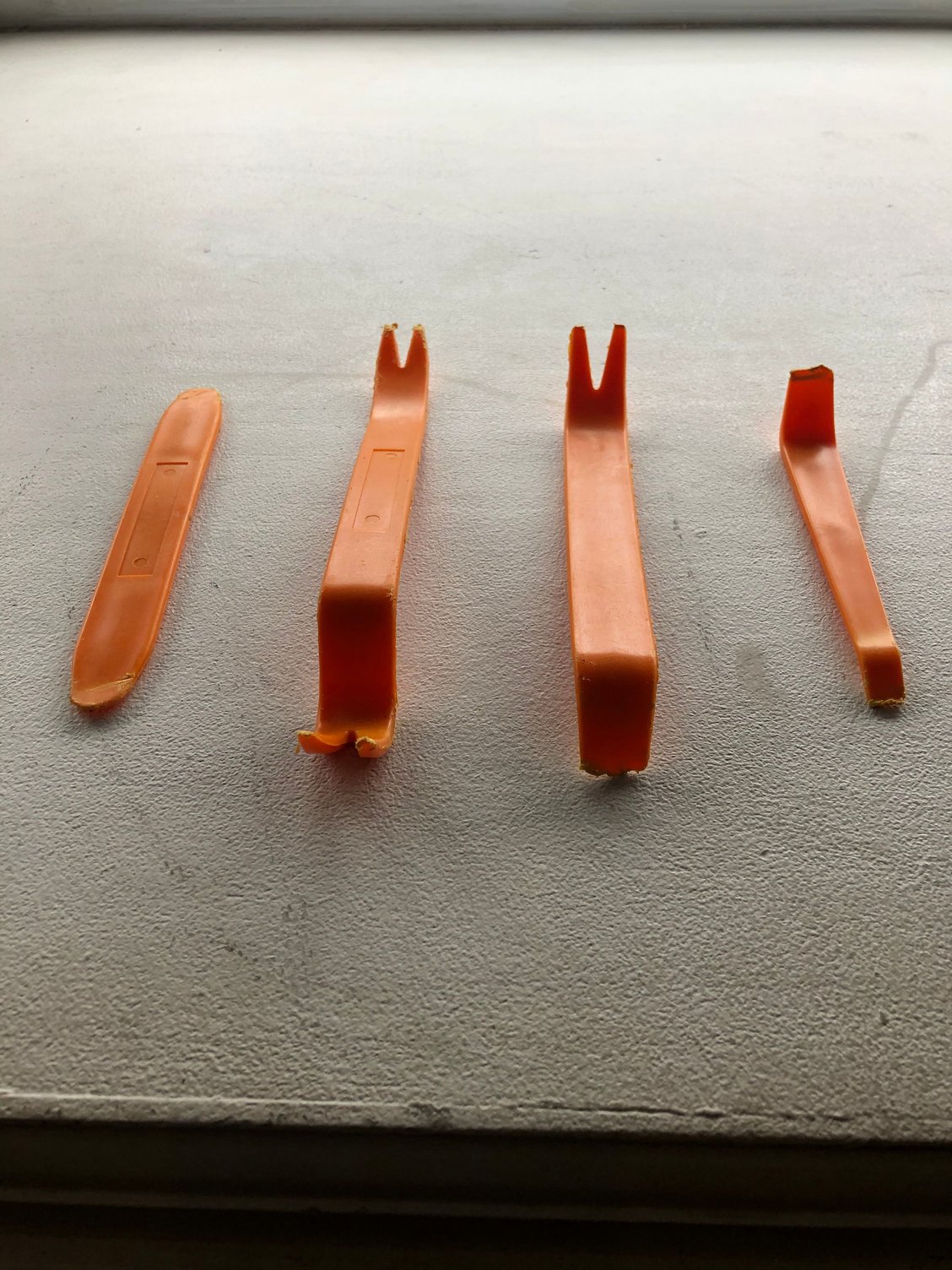

I just installed this rear strip ambient light on my car (see photo) I agree with Shan16 above, you don't need to remove seat cover. As far as special tool, I just used my trim tools (see photo below) to pry the opening wide enough to slip in the wiring. I would imagine to repeat that process in reverse to remove wiring. Is the photo in the link you provided a photo of your car ? if so, I don't see what you're asking since I don't see anything there to remove. If not, then perhaps you could take a pic of your car. Anyways, here to help if you have any questions.
trim removal tools
to pry the opening wide enough to slip in the wiring. I would imagine to repeat that process in reverse to remove wiring. Is the photo in the link you provided a photo of your car ? if so, I don't see what you're asking since I don't see anything there to remove. Anyways, here to help if you have any questions.

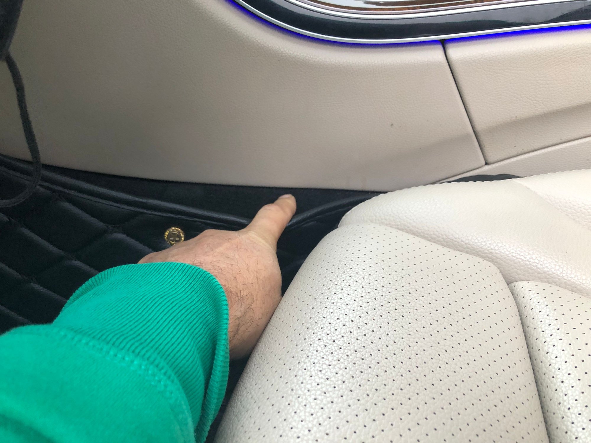

Okay so, I am not 100% sure I understand your question. I don't think you can swap out one piece from one ambient kit and connect it to another but you might. If your question is how do you power it up, Well there are two ways that I know of. One way is to connect it direct to the main harness kit most likely stored above your drivers side footwell light and the other is to connect it to the rear turbine vents provided you already did that install. If you are wiring it up direct to the main harness you simply just run the wire along the center arm console and continue on to the main harness (see photo). If you've previously installed the rear turbine vents, you could connect it to that since there is already power running to the harness. My Rear Seat Ambient Strip wiring harness from DMP came with splitters built in so it connecting it to the rear vents was straight forward as easy as plug and play. Why dont you try texting your question to DMP Car design on WhatsApp to +60 17-607 1426. Just be advised of the time difference (located in Asia)
run wire under this panel from side of rear seat to front of car to the main harness

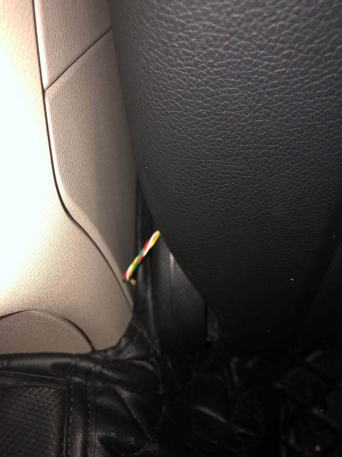

Amigo, as you can see in the attached photos the wire from the Ambient Strip can clearly be seen. I meant to cover them with black electric tape but glad I didn't so you can see them. Once you remove the rear vent cover you can connect them to the rear turbine for power quite easily. send me a private message if you have additional questions.
wire from Rear seat ambient light (drivers side)
wire from rear ambient strip light (Pass side )
