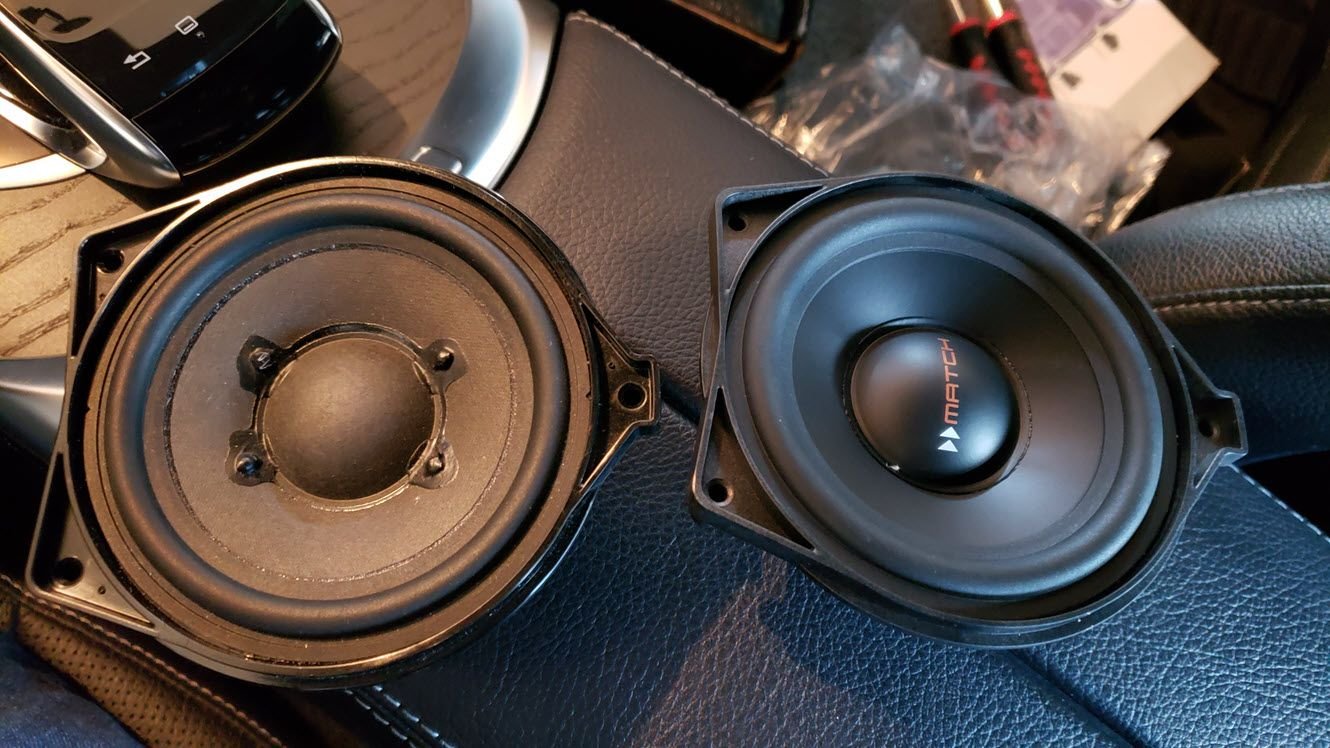

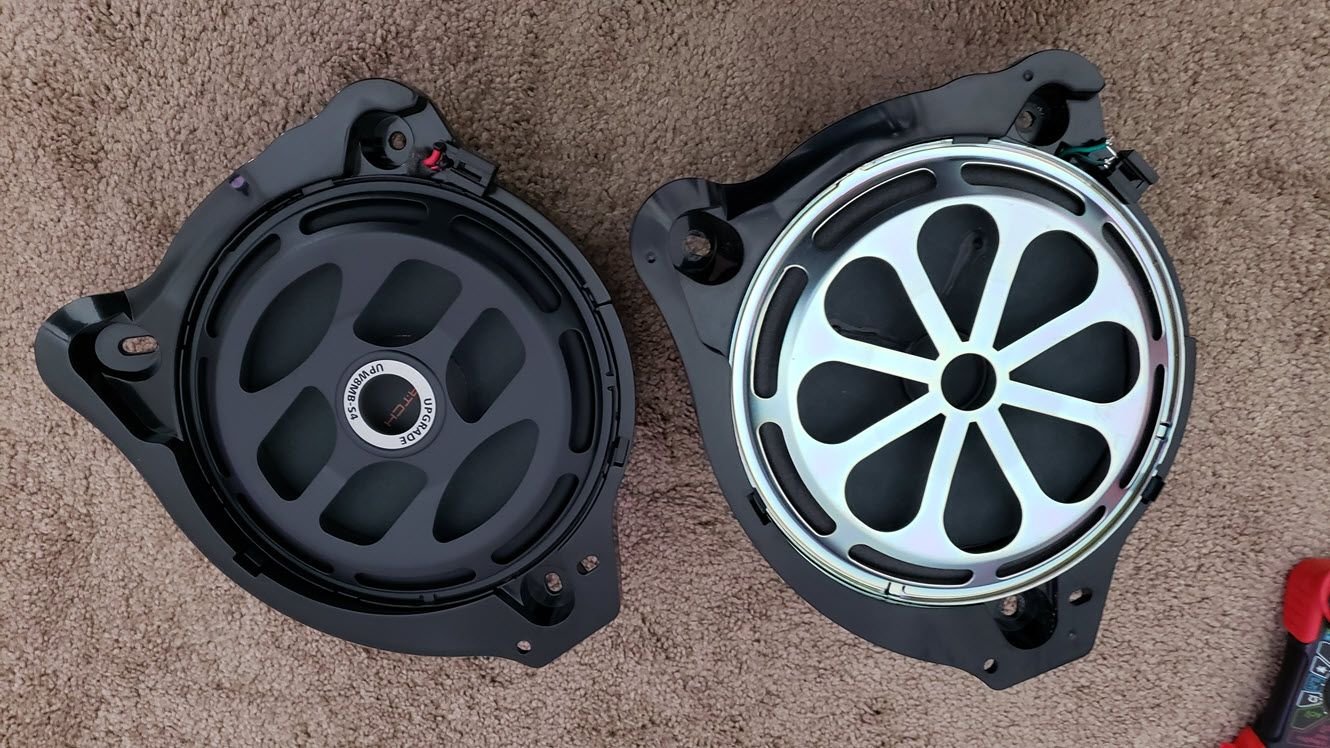

I've been replacing everything Burmester in my car with Audiotec Fischer components and slowly improving the sound. I previously replaced all of the speakers and added a JL Audio Truck subwoofer.

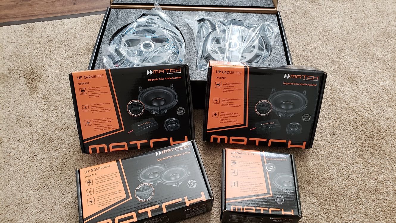

Match UP Speakers for W205 (Complete Set)

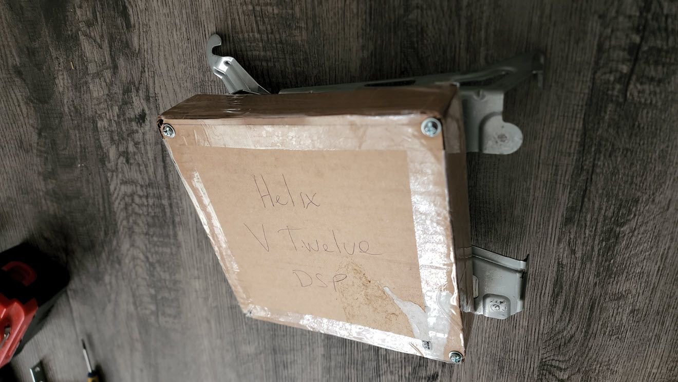

This was the mess in my truck during the prototype phase:
Afterwards

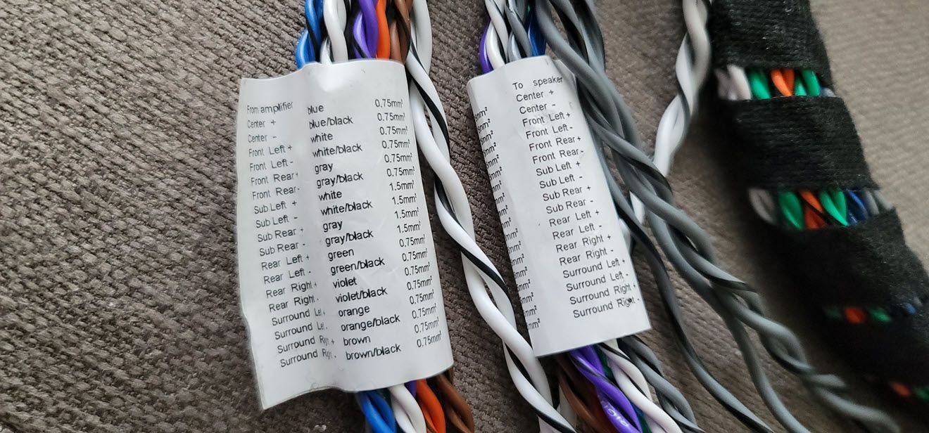

Mounting parts
Prototype DSP
Wire labels are recommended
Cable Management

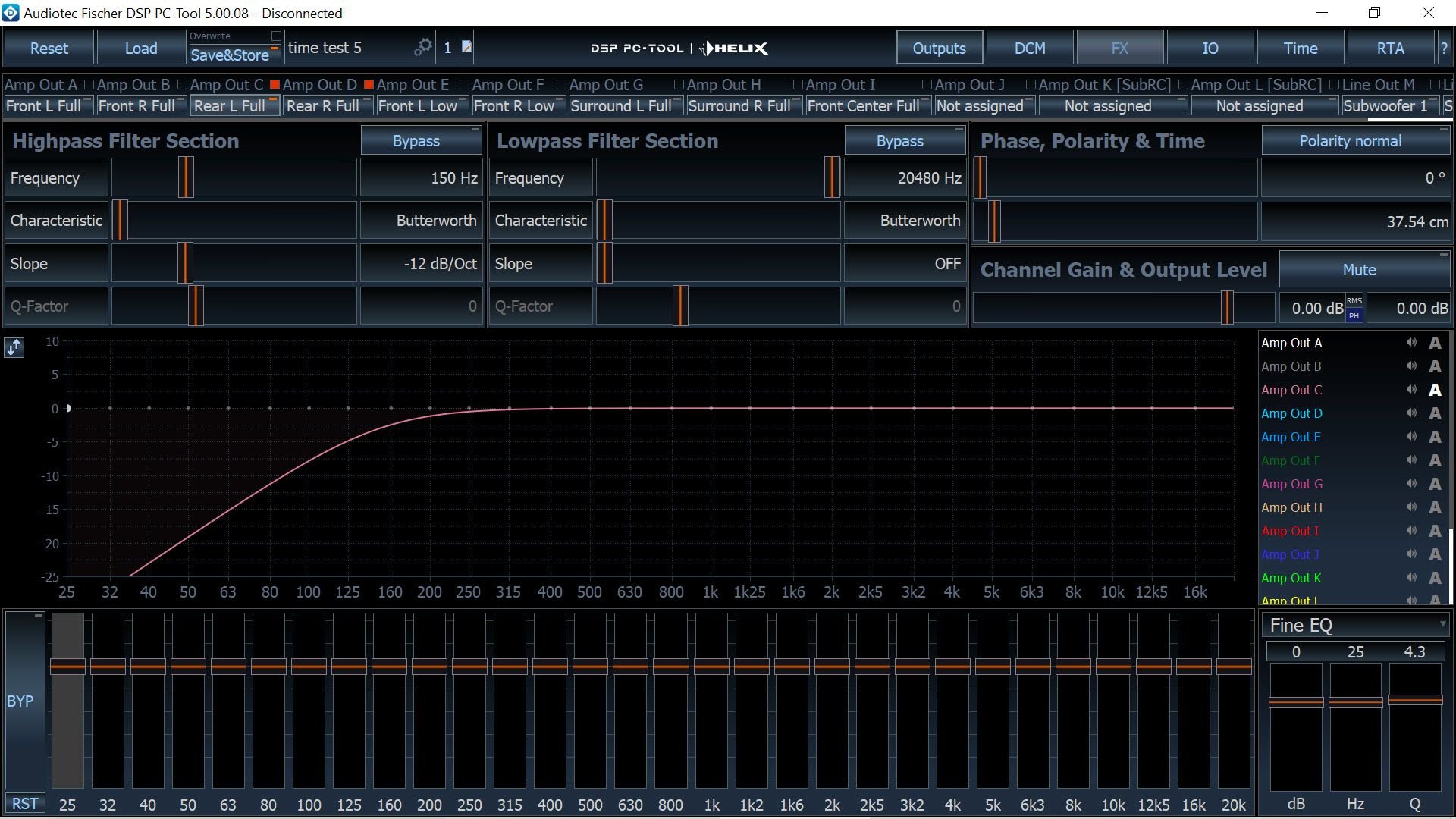

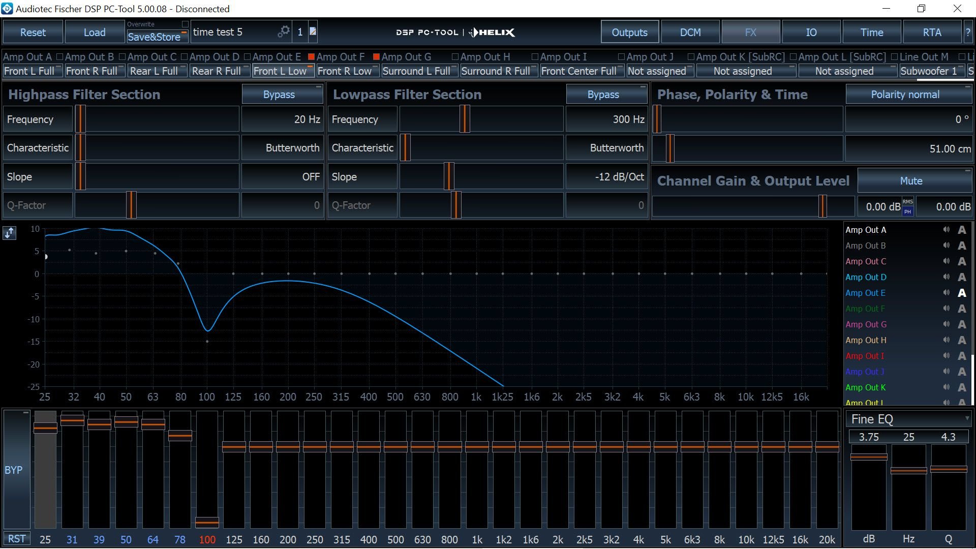

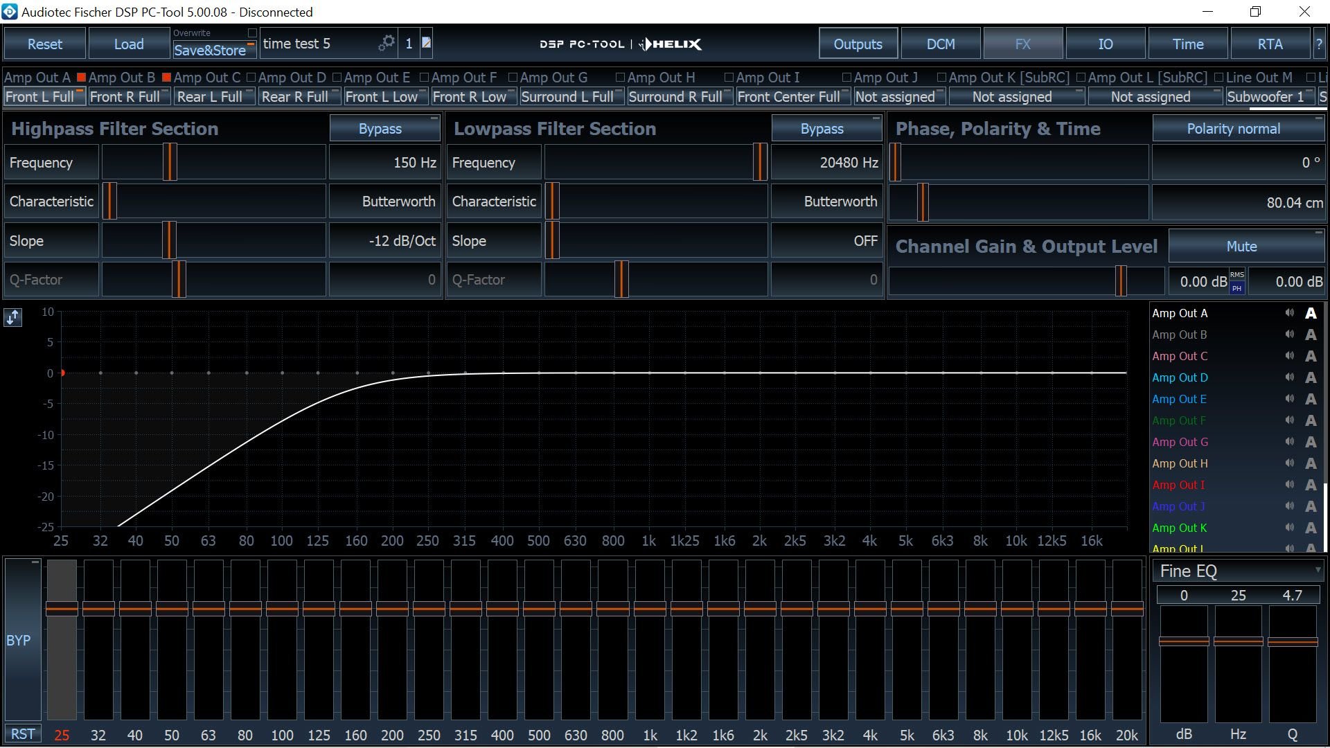

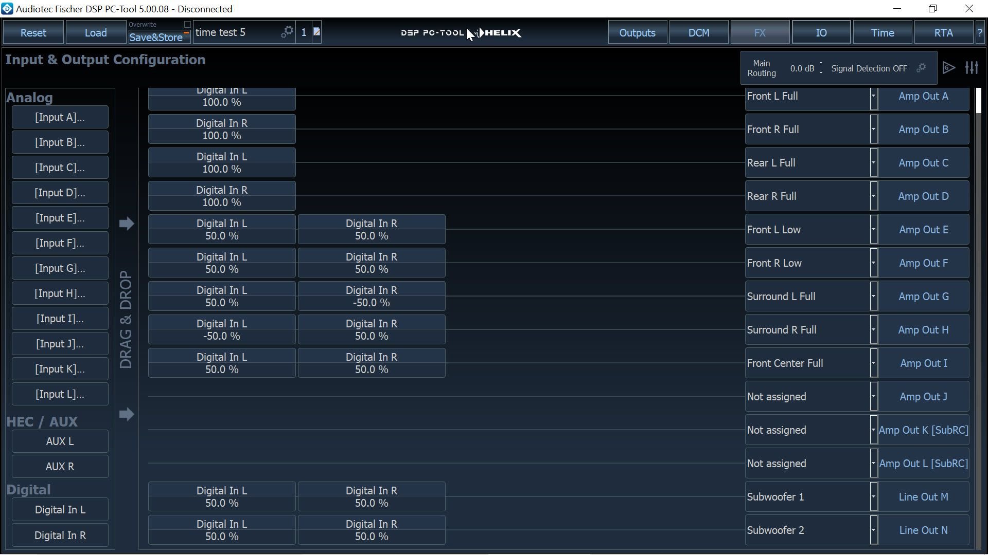

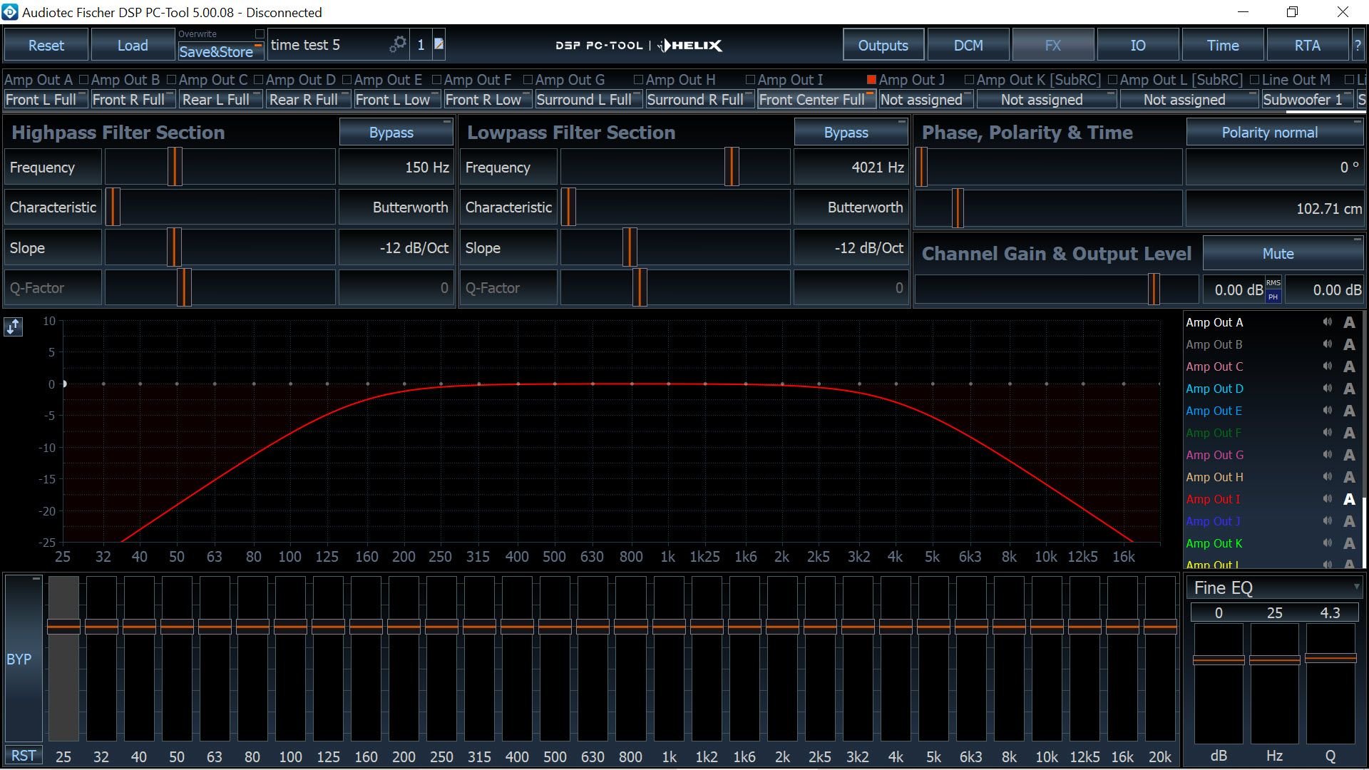

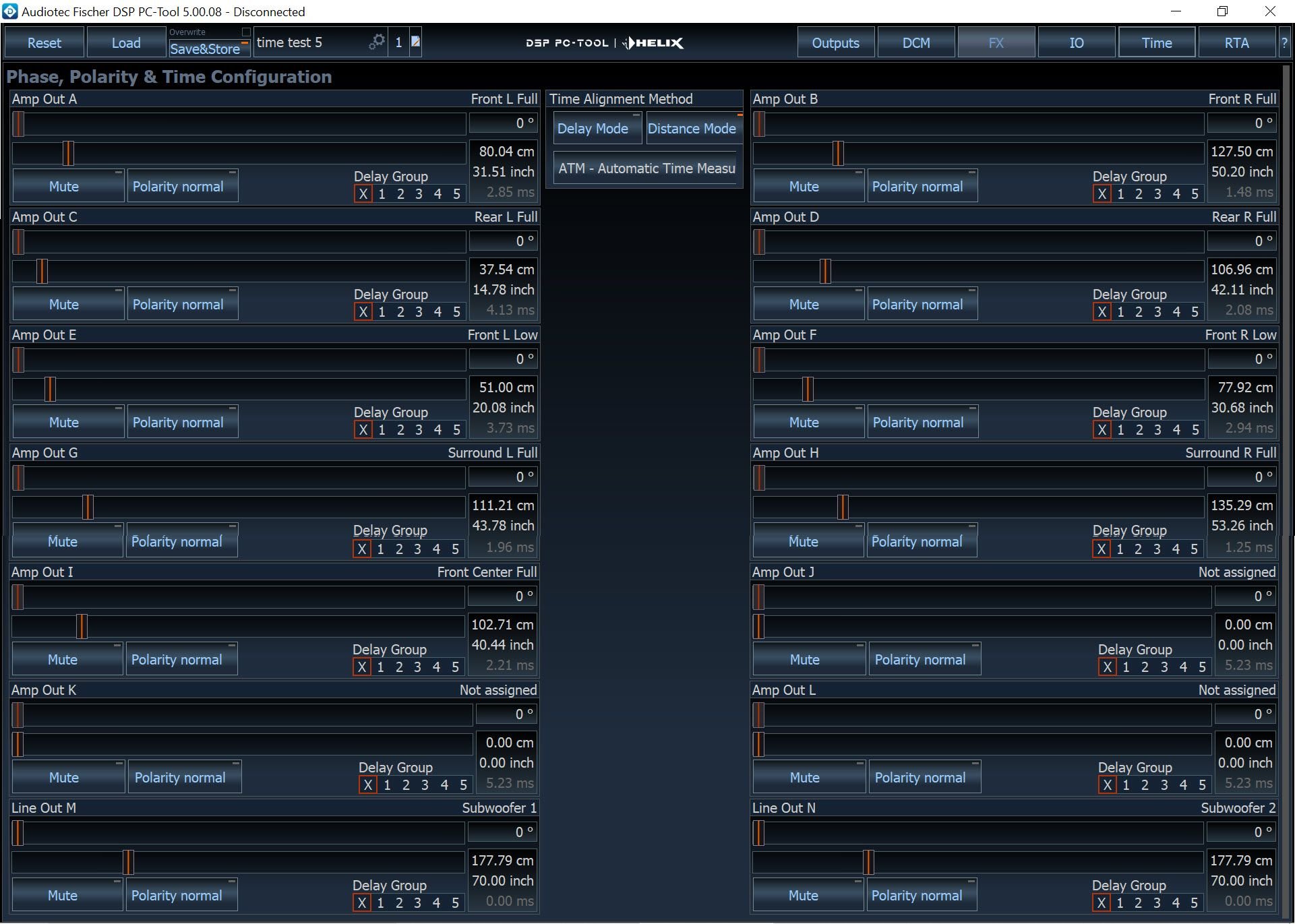

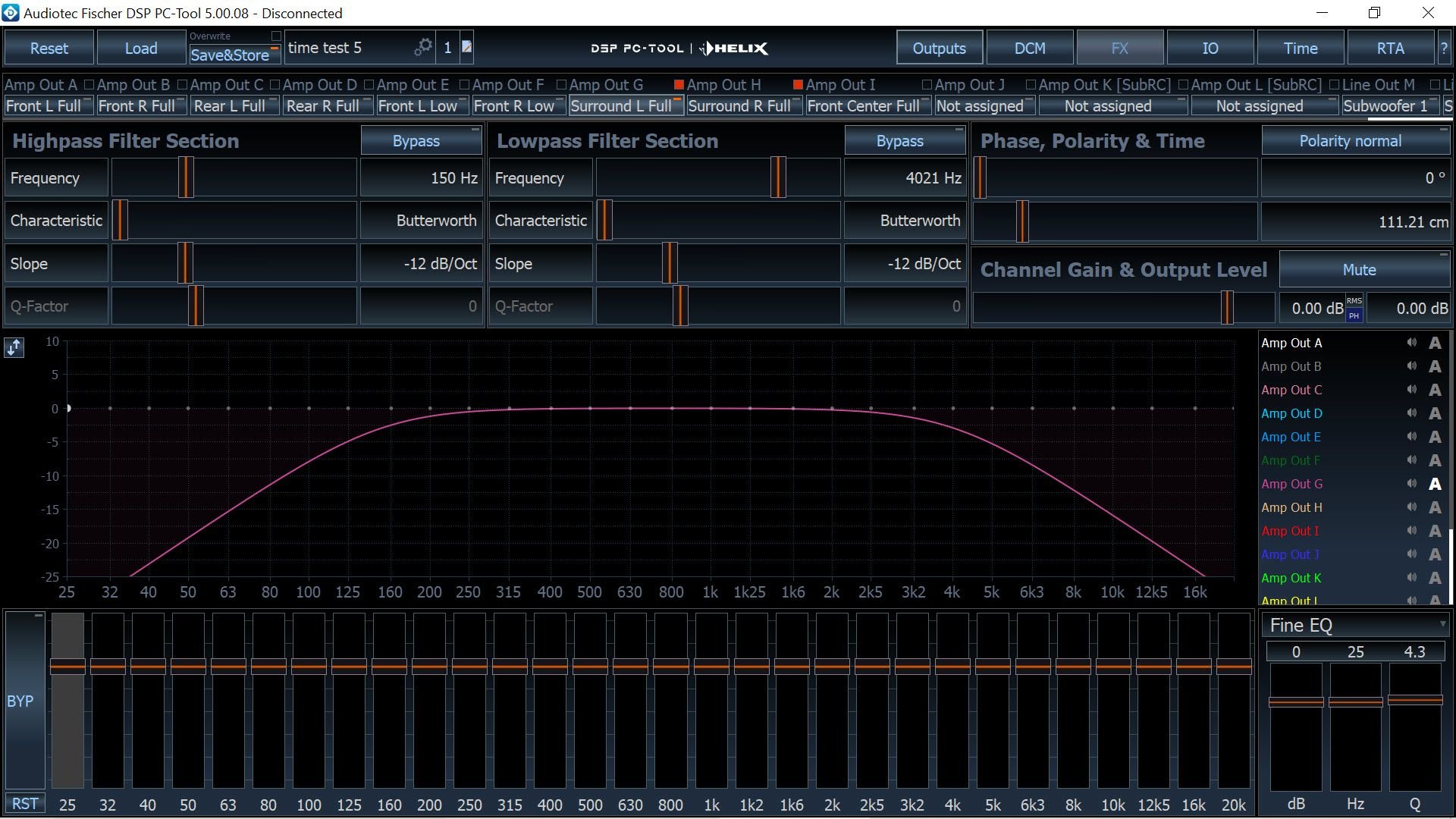

DSP PC Tool V5 Configuration (For V Twelve DSP rev.1)
Input/Output (IO)
Timing
Fronts
Rears
Front Subs
Rear Deck Surrounds (Rear Fill)
Center
Trunk Subwoofer
Old Jan 29, 2023 | 02:39 PM
benzdude's Avatar
Top Answer: 1
Joined: Nov 2003
Posts: 2,412
Likes: 497
From: Earth
2015 C300 4Matic Sport
Talking
DSP PC Tool V5 Configuration (For V Twelve DSP rev.1) File Attached.
