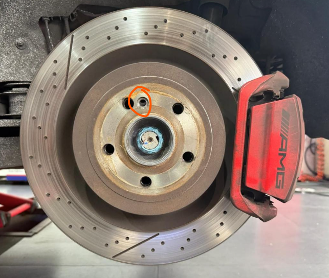

Old May 12, 2025 | 11:06 PM

Just a note on where i circled in orange.... this should line up for the rotor bolt to be secured in place. wondering why yours is not aligned. hmmmm...
Thanks, Dagger!
You're absolutely right — it's not aligned. That retaining screw is really just there for assembly and servicing convenience, so it's not a big deal if it's not used.
But you actually hit the nail on the head regarding why I originally thought mine was the C63 version. That retaining screw is specific to the C63 variant — specifically the Brembo 09.B879.11, as listed in the link you shared. It doesn’t line up with any of the rotors for other W205 models.
So now I'm really curious — do you happen to remember which version you were running, Dagger? Since your rotors fit perfectly with the retaining screw, it’d be super helpful to know. 🧐
Anyway, I just went ahead and ordered two Brembo 09.B879.11 rotors to test my theory. I’ll update once they arrive and I’ve had a chance to fit them. 🤪
Hi, unfortunately its been a long time ago that i have done the upgrade for my previous W205...... when i bought the setup it was a complete set, i did not take note of the part numbers.
I replaced with a set of 2 piece set from Platz motorsport back then after the stock rotors were worn.
I managed to find an old link here, but again there was no rotor part reference. - https://mbworld.org/forums/c-class-w...brake-kit.html
I actually drilled the hole separately on the rotors to retain the screw.
Hope all works well for you!

Hi Dagger, no problem.
I just tried the Brembo one, perfectly fit (except the retaining screw&#129322 no issues at all.. Thanks so much for your insights! 😎
Perfect fit: Brembo 09.B879.11
https://cimg6.ibsrv.net/gimg/www.mbw...4c4a0578e.jpeg
Looks sharp!
