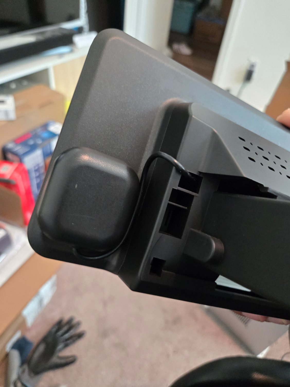

Originally Posted by benzdude
1. OEM music still the same. Android Auto (Tidal) is similar quality as oem, due to newer USB box.
2. You can put the GPS antenna anywhere you want, but it must have a clear view of the sky. Mine is on passenger side top corner. I used a wire guide with a rope to thread the cable behind the glove box. Then up and under the rubber door trim. Easy.
3. No. Those OEM USB ports have different uses for the head unit. Plus you need one oem USB port for Android audio input.
here is where i put my gps so I didnt have to run wires in the dash.
