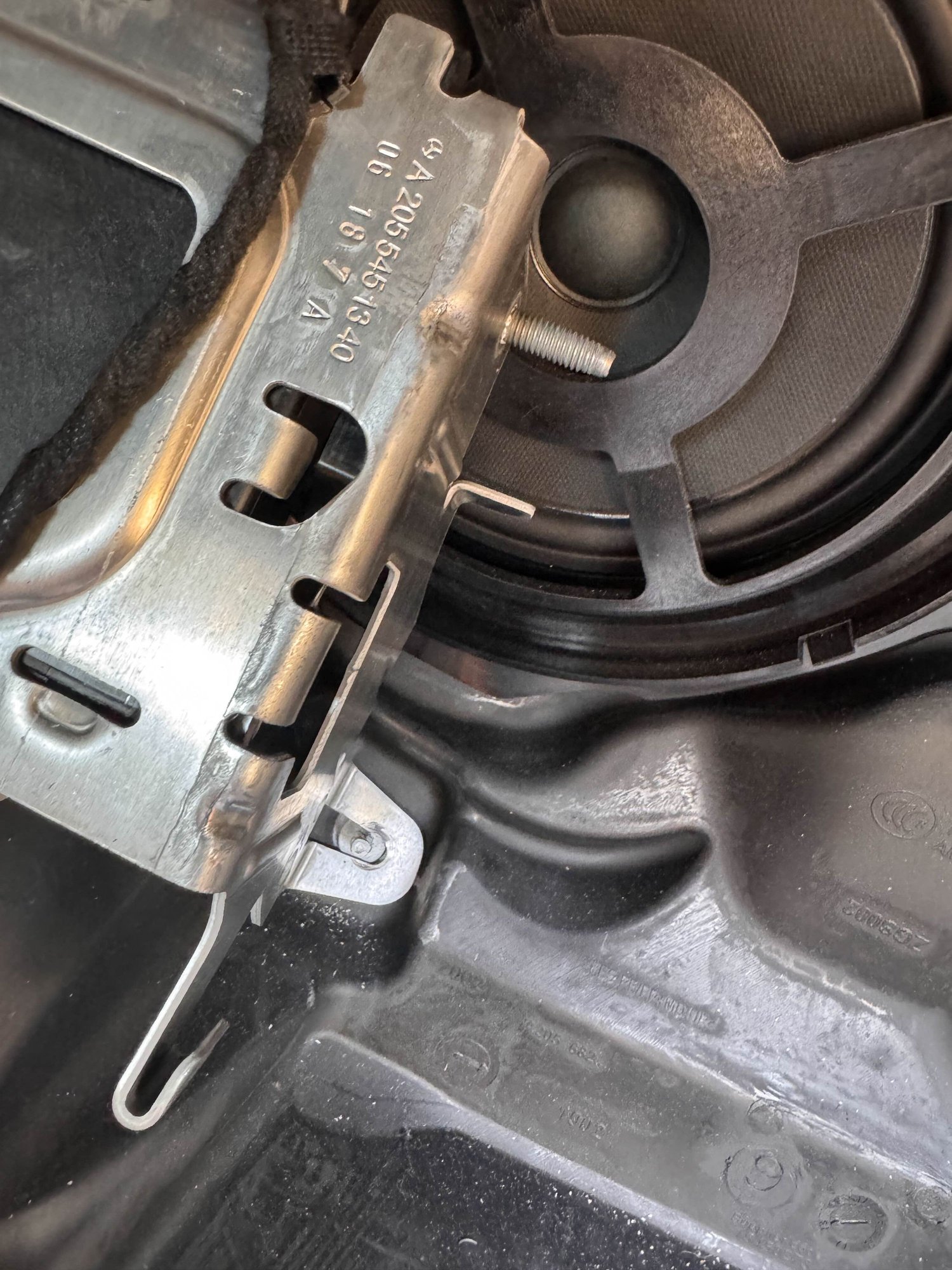

I bought this C300 a couple of months ago. Stock audio is trash. Upgraded the speakers and tweeters, as there weren't even any tweeters. I also got Aliexpress subwoofers for my footwell. I have the passenger side installed, and it sounds infinitely better. I went to wire up the other one on the driver's side, and there isn't a wire there to plug it in, nor a subwoofer, just a firewall cover where the speaker would go. Can anyone help me find solutions to this? Thank you!

you have to buy the sub and it will come with required wire needed to install. if you had a good experience with aliexpress seller just order from them, they probably have it. keep in mind the left and rights speakers fit different.

For the driver side sub its basically a jumper wire from the passenger side: https://www.aliexpress.com/item/4000...39a41802IWxci8

Yes, I have bought the sub and already installed it in the passenger footwell. It sounds good, but there was already a wire there to plug the new sub into. Unlike the driver's side, which I haven't installed because there isn't a wire, and the subs don't come with any wires.
Hello, I've upgraded the front speakers and tweeters to this, https://www.ebay.com/itm/277302286696 . Sounds way better, would recommend or if you want cheaper Aliexpress, but I've never tried those. Also thank you I just ordered the jumper cable!

Thanks for the link, you mentioned that you had to install your passenger side sub. My understanding is that even the base system has the passenger side subwoofer but not the driver side. Or did you just upgrade the passenger side?
When I do an upgrade I plan on going with the plug and play DSP amp: https://www.aliexpress.com/item/1005...920%21%211%210
I think this will go a long way in cutting out the lower frequencies from the tiny 4" door speakers, divert the lower frequencies to the footwell subs as well as add a trunk subwoofer output. It will also add more watts to the system overall.

Hello, hopefully this will help. I have the base system. Not Burmester. The passenger footwell does have a subwoofer. I've replaced it with the Aliexpress subwoofer, which I don't regret. The driver's footwell does not have a subwoofer or wires going to the spot a subwoofer should be in. Also, I'm looking for an amp next. Any cheaper alternatives?
