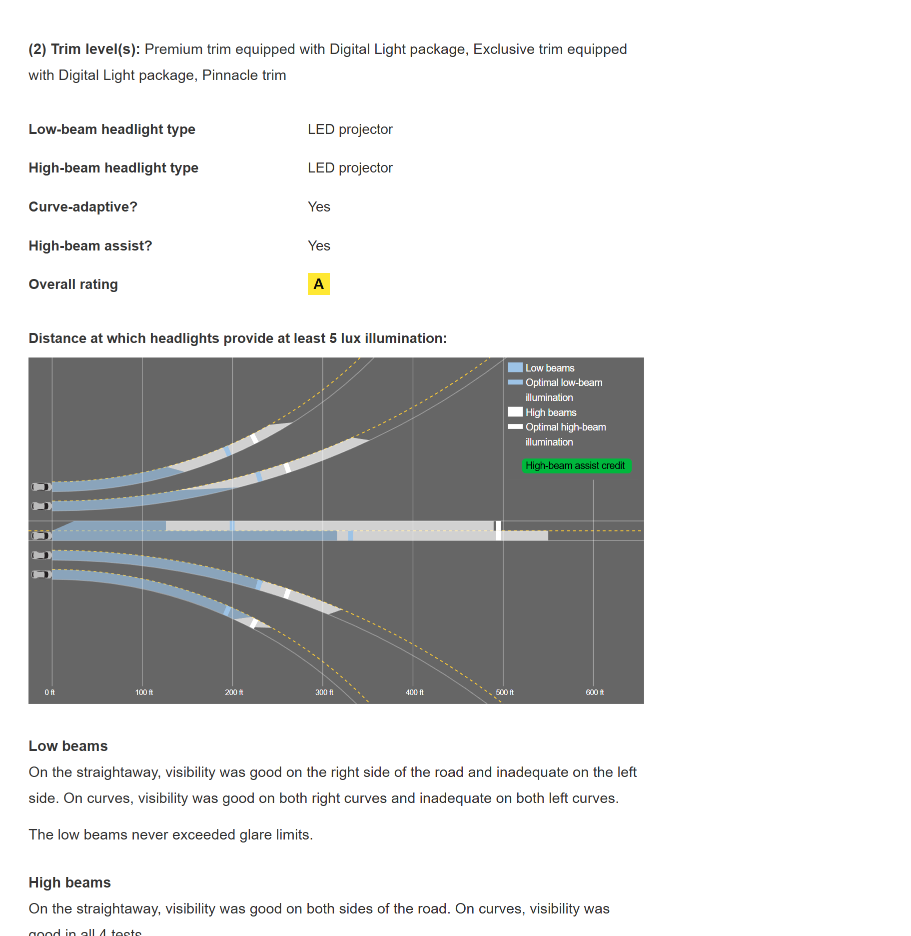

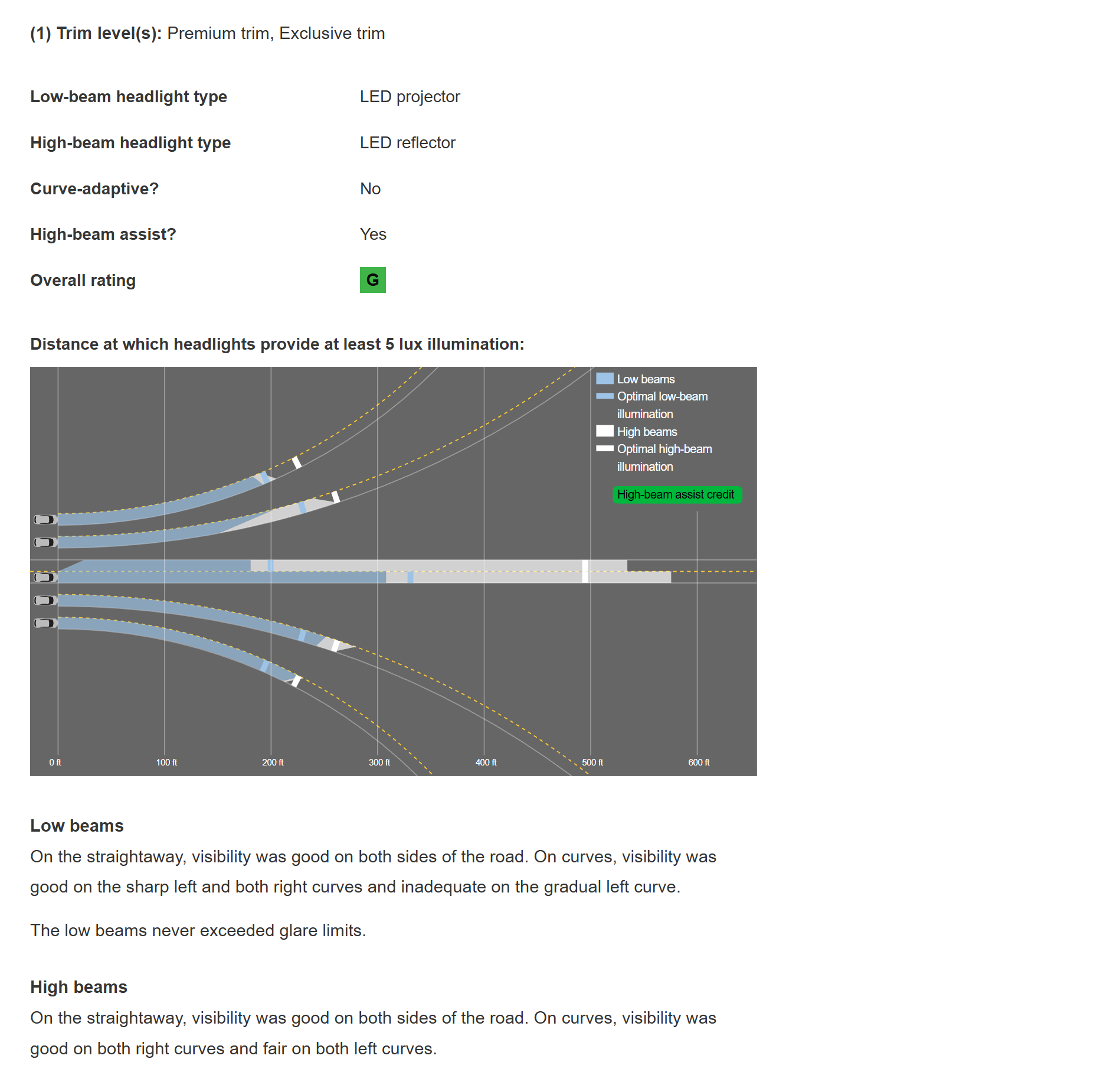

I'm not sure why would you want to retrofit the digital lights when according to iihs they perform worse than the normal led lights maybe because of the looks

As I know, iihs never state that. Can share some links or who said so? Instead, everybody is stating digital light are far better than normal led lights, in what ever aspects except price and cost. Do a simple google by this key word: “Mercedes digital light vs normal led lights iihs” you will know no one said as you state.

They gave digital lights an A for acceptable and the normal ones the G for Good which is better

Thanks for the shared photo, I am sorry. Did not see that before. Seems from aspect of brightness, normal LED wins in USA market. For ECE version digital light, from my personal experience, digital light is brighter than normal LED.
