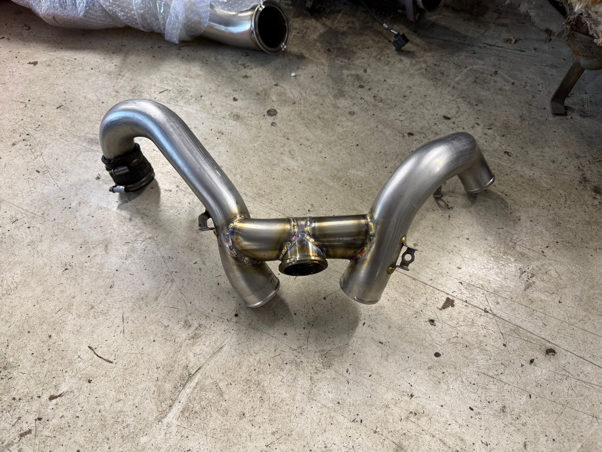

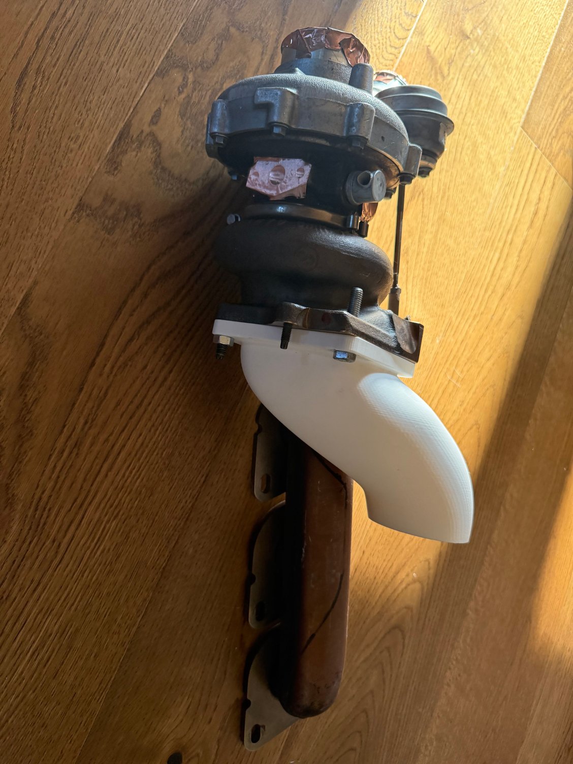

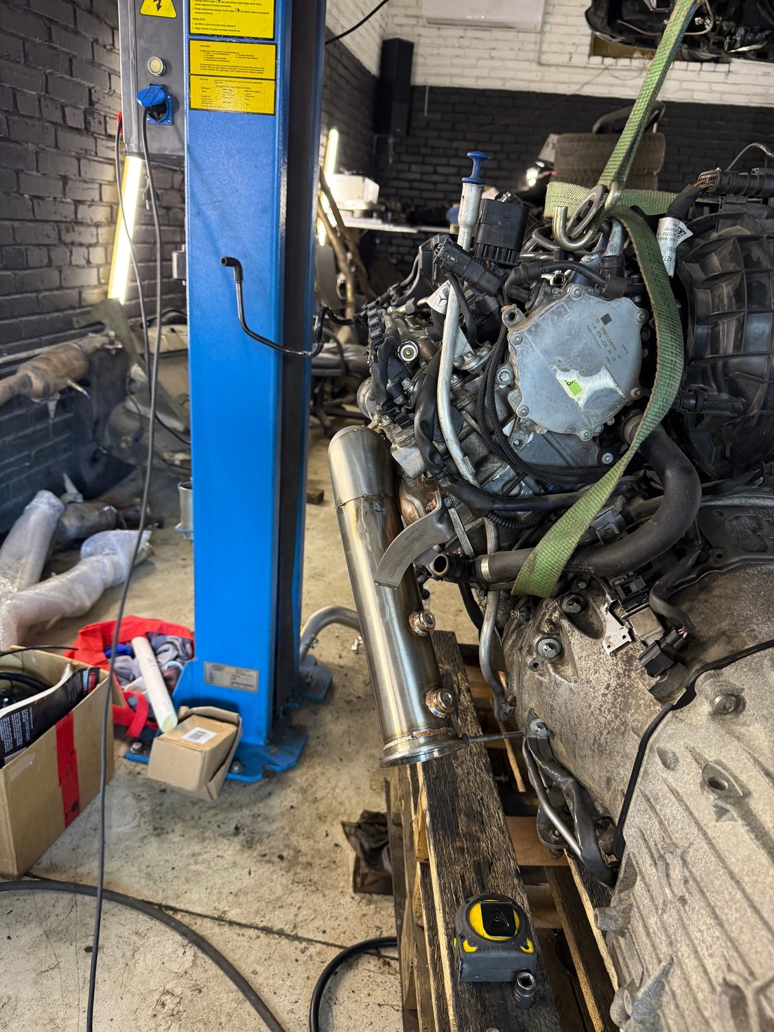

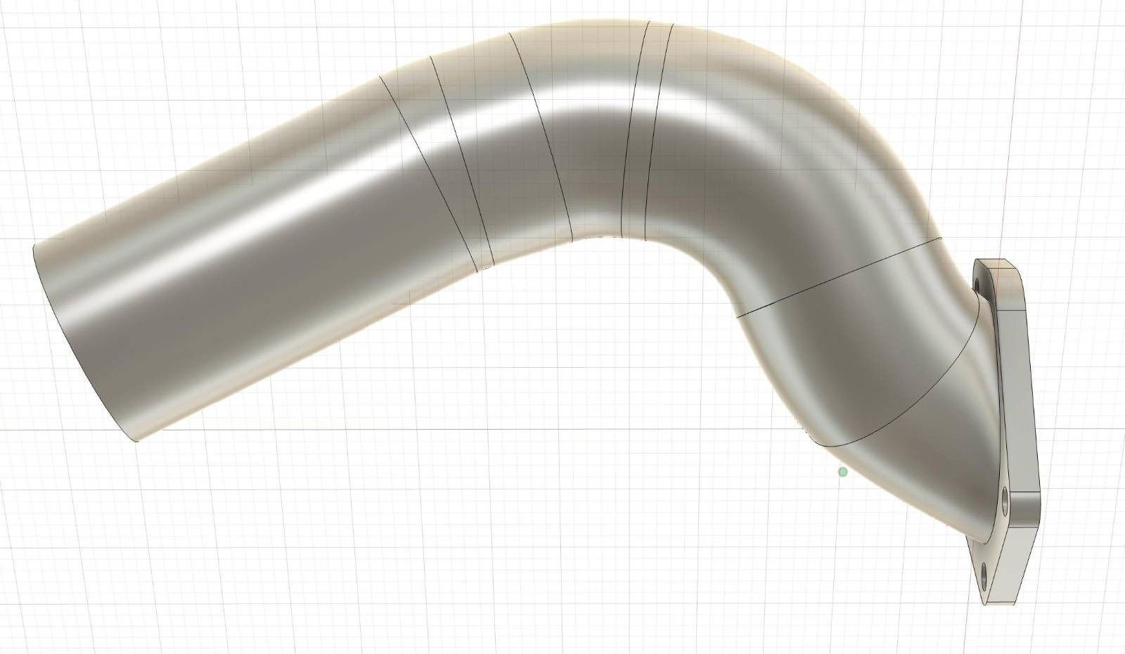

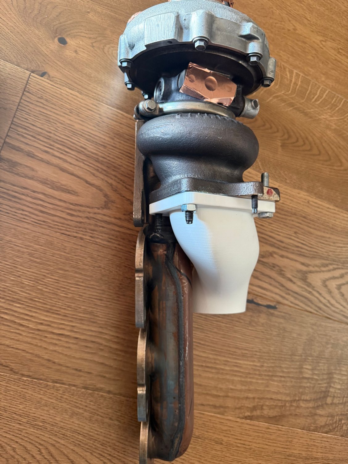

I just finished working on my own, custom downpipes. They are currently being ceramic coated, so not 100% complete. I decided to give 3d-printing a try and here's what I have done with that (more photos of completed pipes to follow). I also have charge pipes modified for a 52mm BOV.

not sure how many people would actually be interested in them. the pipes need custom exhaust work and are not "plug and play" so to speak. the size difference between the 3" and stock are almost double. I will add a side-by-side comparison below to illustrate that. the pipe on the left is stock cat inlet. it would easily fit inside the downpipe with plenty of room left over

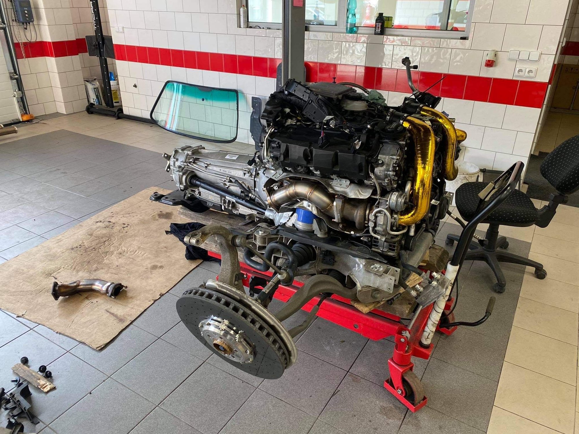

I would need to think about it. all those pipes on my pictures are actually custom fabrication work for my own use. I could figure out the fabrication if anyone would desperatly want something done.. would need charge pipes as cores. the BOV itself is around €400 or so, I believe. oh yeah.. the downpipes are coming together - here's an image of my newly ceramic coated downpipe.

There’s still quite a bit to sort out before the engine and pipes go back into the car. I want everything properly tested and validated before even thinking about offering them to anyone else.
By the way, have you had a chance to check out my build thread? There’s a lot of detailed info in there:
