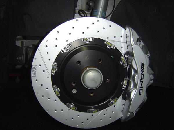

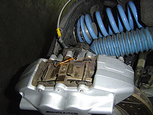

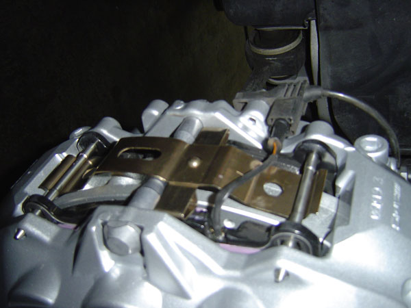

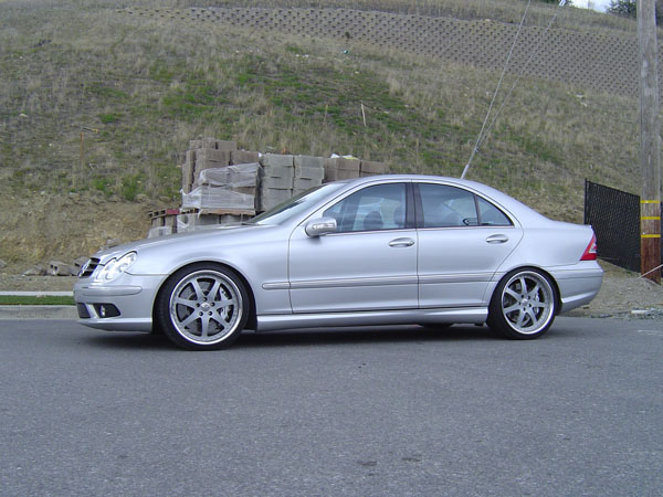

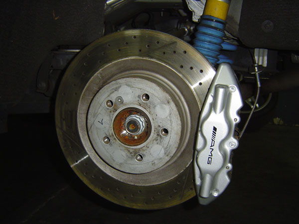

Recently, I had the opportunity to purchase some OEM parts at a super deal, so I opted to upgrade my brakes with the CLK63 setup. After the bedding-in process, the brakes feel much better than the old setup plus some lbs were shed in each corner. I also replaced the lines with Goodridge SS for better brake modulation. Here are come pics
Note: I know a few members on this board did the same upgrade and they were able to cleared the brakes with the stock AMG 18's wheels. However, I was not able to clear mine. After double and triple checking the work, I was still rubbing ever so slightly on the top half of the calipers (not the body but the engraved AMG logo ~1mm). The only conclusion I could come up with was either the calipers were made a little thicker, or most likely my PSS9 coilovers made a very slight change in knuckle's angle which caused the calipers rub.
Attached Thumbnails My new brake upgrades-front1.jpg   My new brake upgrades-front2.jpg   My new brake upgrades-rear1.jpg   My new brake upgrades-rear2.jpg   My new brake upgrades-front3.jpg

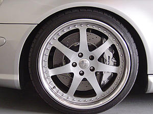

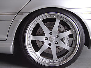

Some more
Attached Thumbnails My new brake upgrades-rear3.jpg   My new brake upgrades-side1.jpg

Well done. I agree the clearance of the fronts is scary close. How did you handle the rear backing plates? Do the brake lines make a noticeable difference?
The braking performance is simply incredible. The car is literally over-braked to the point that you have to worry about drivers behind you. It's as if a parachute is being deployed.

kjb55, bascially the shop trimmed the dust shield to where the calipers and rotors would cleared. The SS lines provides somewhat of a firmer feel but you won't notice much difference for city driving (but since I'm there might as well do it ). I also flushed the whole system and replaced it with Motul RBF600 since I had to bleed the brakes as well.

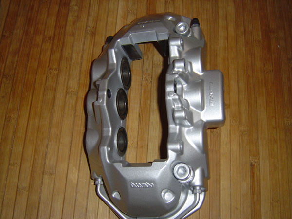

Here is something interesting, when I was getting these installed, we happened to have a new Brembo 14in rotor lying around and I took it to compare it with the AMG rotor. They have the same thickness except the AMG was a little larger in diameter (355mm brembo vs 360mm AMG). The Brembo rotor is a directional vanes design and the AMG is not. Other than that, both uses the same Brembo monoblock 6 piston calipers design. Although for heavy duty track application, I think the Brembo rotor would be a better choice and design (although it seems that the brembo rotor has tighter minimum wear tolerance). I'm wondering if it would be possible to use the Brembo carrier to work with their rotors down the line. Pics:
Attached Thumbnails My new brake upgrades-brembo1.jpg   My new brake upgrades-brembo2.jpg
