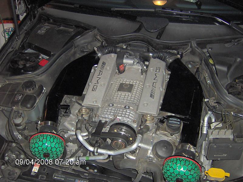

OK, I went to the dark side and experimented a lil!! Took off the SL Y splitter and put on the stock one with the Code III intake (to the rear toward the firewall) and took the boots and the intake tubes from the LET unit and put them on the stock splitter for a CodeLET intake!! Butt dyno says WOW!! Intake whine from the Code III is reduced due to the long LET tubes also taking in air as well. Still get a lil hiss, BUT nothing like just having the Code III on there. Will have to do a dyno in the future. The CodeLET is sorta cool, because you're pulling air from the Code at slower speeds and getting the LET lng tubes to take care of the forced induction with the higher speeds. Butt dyno loves it, ESP and Michelin PS IIs hate it!!! Install took about an hour.

Any pics of the project that you can post?

You mean like this?
Cost = $40
Install = 10 minutes
Of course I just threw some foam motorcycle filters on the end, and they aren't pretty. Standard 2.5" tubing fits right into the stock intake. I tested so many different intake setups, and have loads of road and dyno datalogging. I can tell you that this type of intake makes between no power and less power. The stock airboxes work very well, they were not the problem, the restriction at the TB was the issue...This is why we developed the intake we now sell. The specific setup pictured didn't stay on the car very long. The only reason this type of intake shows gains on other vehicles is because of the SL55 splitter, not because of the tubes, and those gains are almost completely at the top end, not throughout the powerband.

whats hiding in the bottom middle of the pic?
+1

whats hiding under the white-out pic?
a prototype part under development that he doesn't want us to see
i looked at my engine from that angle, i could see ancillary pullies (crank, waterpump etc)

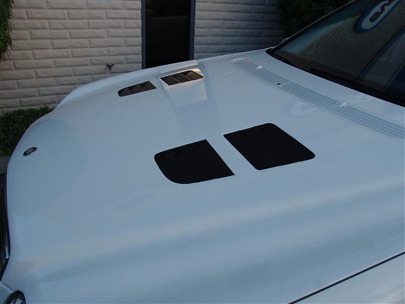

I do feel based on the comments made by others that it definitely sounds like you are getting the best of both worlds...now if only to modify the rear area to force colder air into the C3P intake then it will be wow....maybe a plastic attachment going from C3P intake and up to the hood and maybe screen it
something like in this pic but up by the C3P intake.

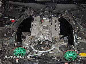

ME?? NO, I did not!! The HP, only the dyno knows and its too soon to tell how she'll do at the strip. Again, this is an experiment, not a given. My philosophy is that you can NEVER have too much airflow or too much air as long as you're not lean. Superchargers love air and lots of it. Cold air is even better!! I 'll run it awhile and see what she does. Its a 10 minute install or swap out since I have BOTH the CODE III and the LET!!
Attached Thumbnails Running BOTH Code III and LET Intakes!!!-benz-photos-015.jpg   Running BOTH Code III and LET Intakes!!!-benz-photos-016.jpg

Originally Posted by c32used
Glenn props to you for being creative
I like that hood, who has one??? That'll would be a real boon to evacuate some of the hot compartment air AWAY from the supercharger. Do they sell this mod or was it a cut-out of the hood?? I like the look too!!
