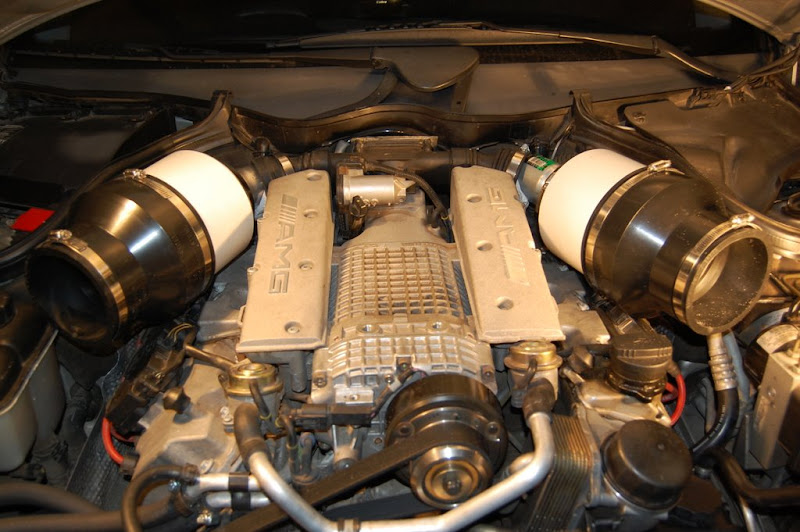

Guess some photographs would be good so we can compare before, and after... No more progress as of yet, but hopefully get some work done tomorrow. Took these on my phone, so not the best quality ever.
Attached Thumbnails C32 Custom Intake-c32intake.jpg   C32 Custom Intake-c32intake2.jpg

Likes: 17
From: NY
'03C32 Obsidian Black, '76Toyota Celica GT TRD, '12R350 4matic Arctic White, '06 ML 350 arctic white
can't wait to see the end product

I came up with a completely sealed design today. You won't be able to see the filters anymore, but with an acrylic tube you would. The setup will have 4" tube leading from the air ram ports to the filter enclosure. Found all of this at Lowes. Home Depot, and the other stores don't seem to carry 6" PVC. Of course, you could just use smaller filters. Cost for everything will be slightly over $100 dollars, so we're looking at a total cost of around $170 now. Basically the 6" PVC will be the filter enclosure. Then 6"x4" couplers to 4" flexible tubing. 4"x4" coupler for the tubing to air ports. Hoping to get it thrown together tonight, and I'll be able to post up some photographs after work tomorrow...
4" flexible tubing
2x 4"x4" coupler
2x 6"x4" coupler
2x 6" PVC or acrylic section
Old Dec 8, 2009 | 11:02 PM

I really would prefer the filters being visible, and will most likely buy some acrylic tubes down the road, but this is going to work great for now. Just throwing it together tonight, but I will also paint everything later on. After some debate it was decided the only possible way for a cold air supply, even at idle, was with a sealed system. So, it will have increased air flow, more horsepower, no heating issues, and the filters are reusable. Considering the total cost so far I think it's worth it. Now lets see if it will work, so I'm off to the cold garage for a few hours...

So, here's the update... Turns out there wasn't enough room in the engine bay to fit that huge coupler. The hood wouldn't shut... It did look like two huge turbos almost. All that stuff will be returned. I have a new plan now that is a lot cheaper. I'm just going to cut, and place an end cap on the open side of the pvc enclosures with an opening for the air ports. Thinking around 3" tubing should be good enough... Not sure what the end result will be, but I'm off to find another solution.

I remember reading that now... Looks really nice! This is what I came up with for new supplies. I'm going to be using a 6"x4" metal adapter, and 4" metal ducting. The metal coupler will work because it isn't half an inch thick on each side, and I can bend that ducting unlike the plastic tubing I bought at first... The stuff cost around $30 dollars at Lowes, so we're right below $100 in total supplies. I really wanted to avoid using metal at first, but I still have that thick PVC heat shield right at the filters where it heats up the most.

So, how's the intake look so far? It's 100% now except for additional heat shield material, and top it off with a nice paint job. It almost looks like overkill. I could see this intake on a 1000HP supra...
