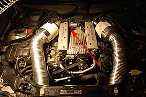

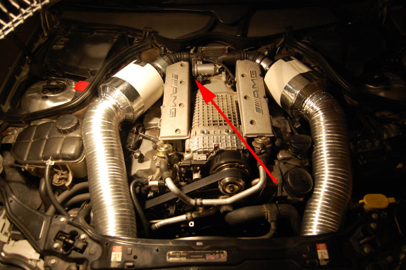

Look down in this groove, and you will see the vacuum line. It's connected as a pressure fitting. The solid pipe is held in place by the rubber piece... Not to say this is your problem, as it could be another line, or something else completely. This line is what caused the same exact issues for me though.
I have checked the vacuum lines and all seem fine and I have replaced the crankshaft position sensor. The car still has the same issues. I have removed the map sensor and visually checked it and it was clean. I tried unplugging the harness going into the tps and following the steps about leaving it unplugged for a minute etc. and nothing seems to be helping. I appreciate all the advice and suggestions but does anyone have anything else I can try? If not, it will be going to the dealer shortly.
