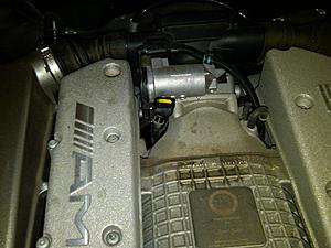

have 84K miles and just had a routine transmission fluid change. prior to the change I was not having any shifting problems. since 1 and 2 gears slip intermittently. tends to improve as the transmission warms. was told it may be due to sludge or particles that got into the valves during the flush? Lucas oil makes a transmission fix. has anyone tired this in the past. Is the yellow cap the transmission stem in the picure?

That's where you insert the dipstick for the oil level.

Thanks, not a simple find for the transmission stem.
