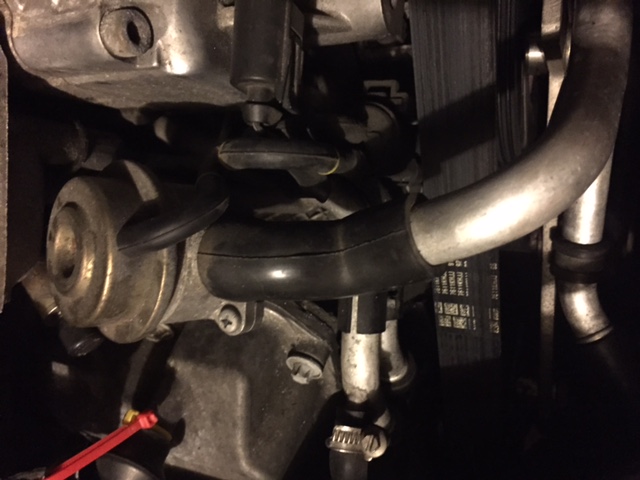

I have a Memoscan u581 and I was looking at live data and took 2 pictures with hope someone can identify what these may point to...
picture 9394 I presume means secondary air pump but wondering if it means pump itself bad or what it feeds has fault
picture 9395 fuel sys1/2 OL,Fault means what to the C32? I heard those usually applies to Diesel engines which then I understand why a fault
this shows up when I first start car and engine is cold and I let idle while secondary air pump is on engine revs fine but very shortly after secondary air pump turns off my engine runs rough and p0303 shows up...I can clear code but til engine gets warm like 60 degrees the code returns and engine revs rough but if I clear code and engine is 60 degrees and start car again engine revs fine and no code at all. I don't think it has nothing to do with plugs changed last summer and issue there before If I recall right nor wires or coil packs because swapped many times. Compression is at 150 psi on cylinders 1-4 so didn't bother checking 5/6. Fuel rail pressure sits on 60 psi and new fuel filter thus new fuel regulator. CPS new like 2 summers. Cleaned fuel injectors thru fuel injector cleaner added to fuel. Last summer my friend changed my alternator prior to new plugs thus removed secondary air pump and after all was put back a weird grinding like sound was on while secondary air pump on..car stored in my garage so I didn't turn car on til next day or so...the noise was again so I looked further into it. I saw that picture 9400 and 9401 the metal tubing fed by secondary air pump wasn't fully inserted in the rubber hose connected to EGR on passenger side if I recall right but after I pushed it in rest of way that weird grinding like noise was gone and never returned so my conclusion is the pump is fine. Opinions??
